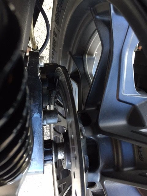

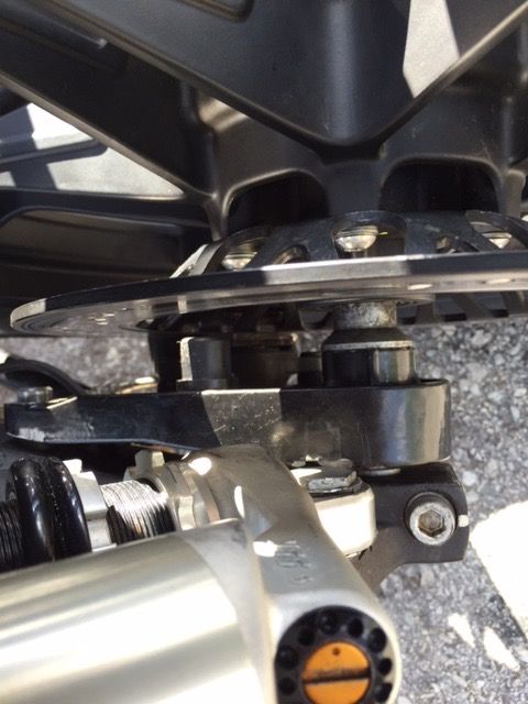

The weather finally cleared up for me to take it for a ride, and now my speedo doesn't work. Looking at the rear wheel sensor, it's not close enough to the rotor to pickup anything. If I wave a wrench close to it, the speedo does get a reading. It appears that I can wave a wrench at 25MPH!
Anybody know what I need to do to get the speedo working correctly? FWIW, I did use stainless bolts to mount the rotor, but the bolts aren't even close to the sender.
Ken
Here's some pics of where the sender is in relationship to the rotor and wheel.
Ken

I assume there are no shims on the sensor.
It sounds like the sensor mount needs to be carefully bored out to permit the sensor to sit deeper. I wonder if there's a different sensor on later models? Or a different mounting bracket?

Ok, If I've not had too much vodka to measure tonight I'm getting 0.061-0.062" (1.55-1.58mm). But it's hard to access and the bike is currently parked tight to the Harley and it's stupid hot out there.
Sensor looks like it's under a plastic cover and I'm measuring between the end of the plastic and the rear brake rotor bolt head.

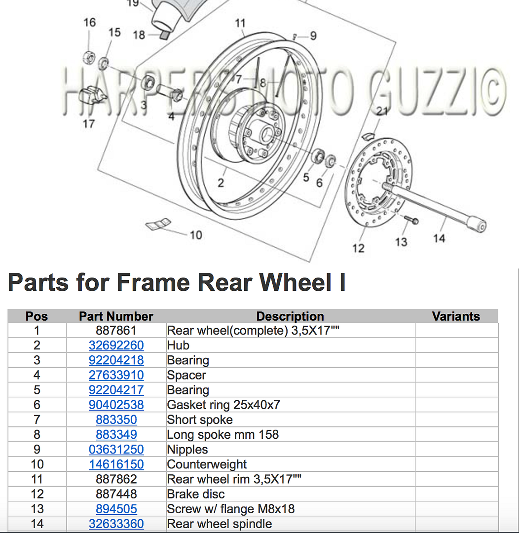

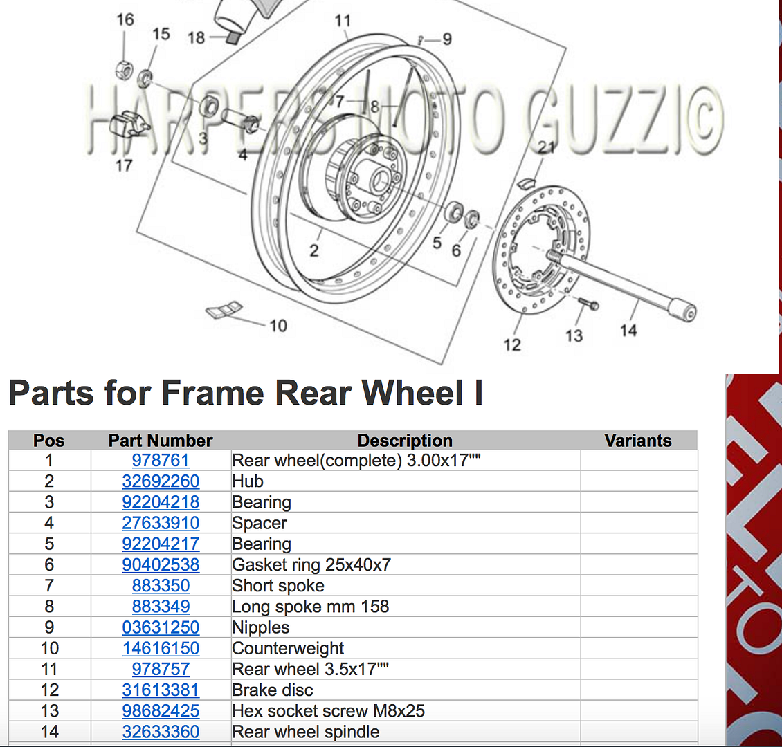

It makes much more sense now. Didn't MG switch to an an aluminum or alloy wire wheel in 2012? Brake rotors are the same between the wire wheel and alloy wheel from 2012 and newer. With that being said, you can't directly swap a rear wheel from 2012 or newer on to a 2009-2011 V7.
From what I can tell, the swing arm is the same from 2009-2015. If you want to put Stone cast wheels on your 2009-2011 V7, you'll also need the caliper, rotor, and speed sensor unless you want to rig something else up for the speed sensor (the rotor and caliper from my 2009 still bolt on and work normally). I suppose you can run it without the sensor, but you won't know your MPH and your odometer won't work. I also noticed that my bike is running a little rough, but I'm thinking it may be related to the speed sensor not working. We'll see once I get this all sorted out.
I'm also hoping that Harper's doesn't have an issue with me borrowing their photos. Curtis has always been a big help to me.
Ken
2009-2011 Wire Wheel
2012+ Wire Wheel
2012 Cast Wheel
