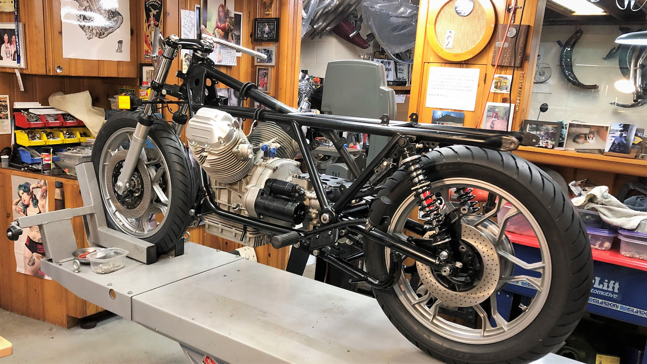

I confirmed my starter switch works when I ground the handlebar against the frame using a piece of wire. So I'll drop the forks down and clean off the powder either inside or the top of the clip-on cylinder that slides over the stanchion.  Another ground issue... my headlights work but the front turn signals only work if I ground them with a wire against the mounting bolt. I was hoping my rapidly flashing signals would be fixed with new bulbs but that didn't resolve it.
Next problem... I found my front fender is slightly rubbing the tire on one side high on the mounting tab. I can barely slip a sheet of paper through the other side.  It's a 100/90 Avon RoadRider Mk2 tire.  Anyone run into this problem?  I'm going transfer the area where it rubs onto the fender with chalk and perhaps Dremel some material away if it's not too bad else I need a different/narrower tire.  It looks like Avon makes a 90/90 x 18 if I can't get it to work.
