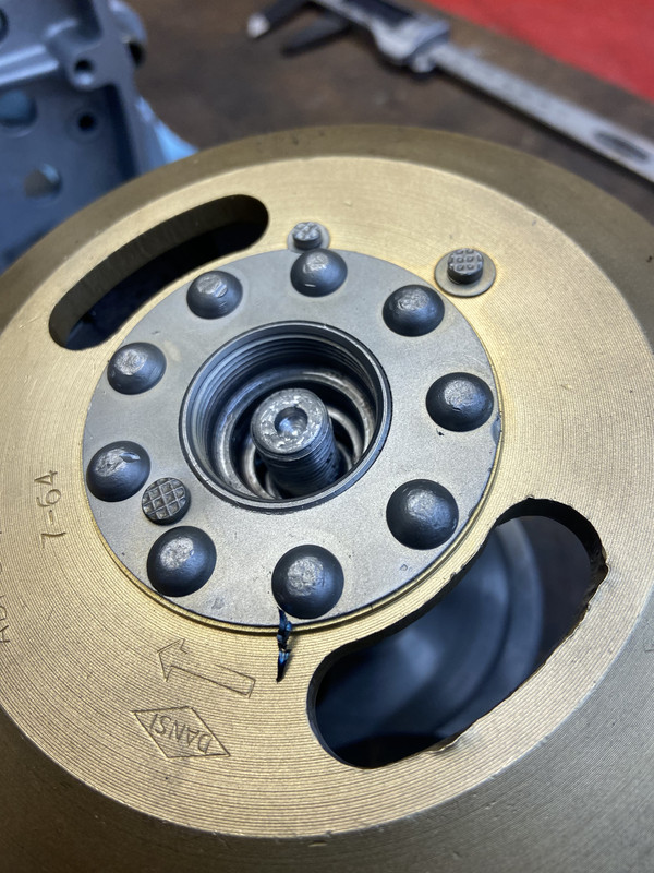

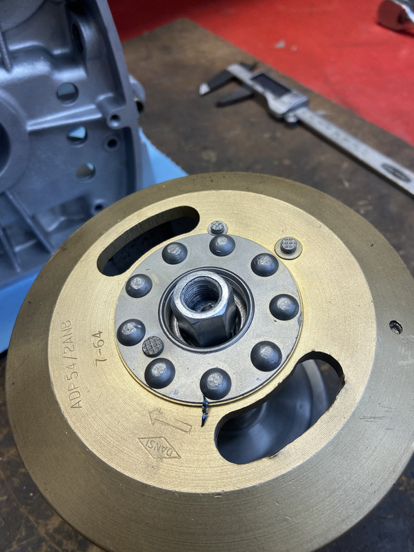

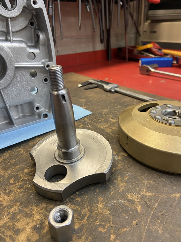

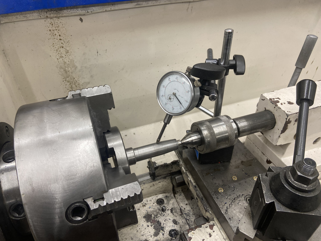

Well after planning on drilling, tapping and fitting a stud I changed course, thought what have I got to loose trying to build up the crank, worst case I just grind off the attempted weld and threading and go with the original plan.
four jaw chuck centered the piece with a dial indicator. Not the easiest piece to secure in the jaws, with the weight on the back of the web three jaws just reach the sides of the flywheel. I trued the face with a dial indicator as well and found the shaft is slightly bent, I can true the tip but the bearing contact surface is then out so I went for the mid length, I don't think I would use this piece given the slight bend (about 15 thousands +/-).
I bet someone went to town with a hammer trying to get the flywheel off after tearing the puller threads out of the rotor.
I welded and turned the extension a couple times, weld imperfections kept showing up until I got it as good as I can
I threaded it with a die, 1st attempt not the best, re-welded it and turned it once again and used a new tap M12 x 1.25. I had turned the stud end to 11.85 mm before placing the die, could not get the die to start at 12.0 mm.
The threads are pretty tight, it would have been better if the threads were lathe cut but I can't seem to figure out the gear box on my lathe, can't get the lead screw operation to reverse, needs some digging into.....
I built up the threads an extra 10mm from the original good crank I have, setting the rotor over the shaft it seemed it could use more length on the threaded end
It will work, just not sure I would use the piece but it was worth the effort

Very nice work! Jim(?)
Using a die means you did not have to cut a thread relief at the crank end of the thread.
Interesting that you could not get the die started at 12.0mm, but it worked at 11.85mm.  0.006" smaller diameter for us Yanks.
Always fascinates me what a big difference a few thousands of an inch can make in metal work.
I salute you from afar!   :thumb:

Do you plan to test your repair by installing the flywheel and torquing the nut?

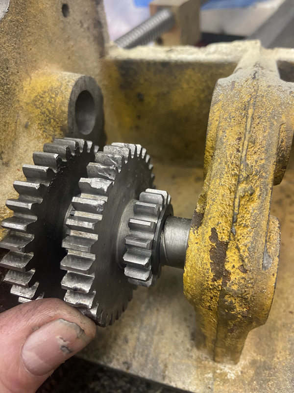

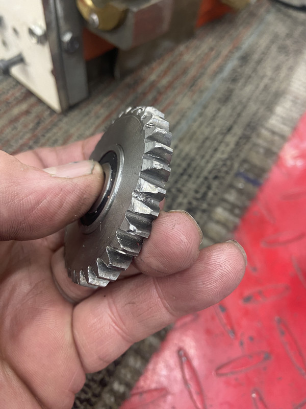

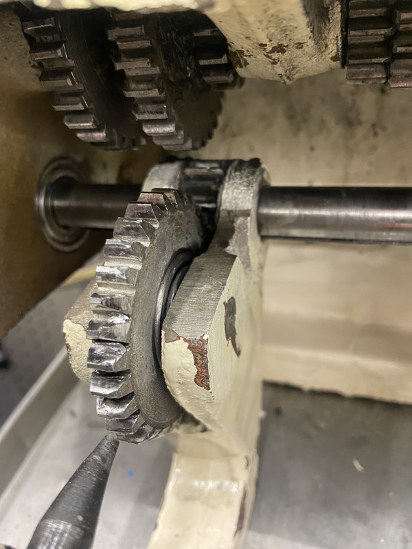

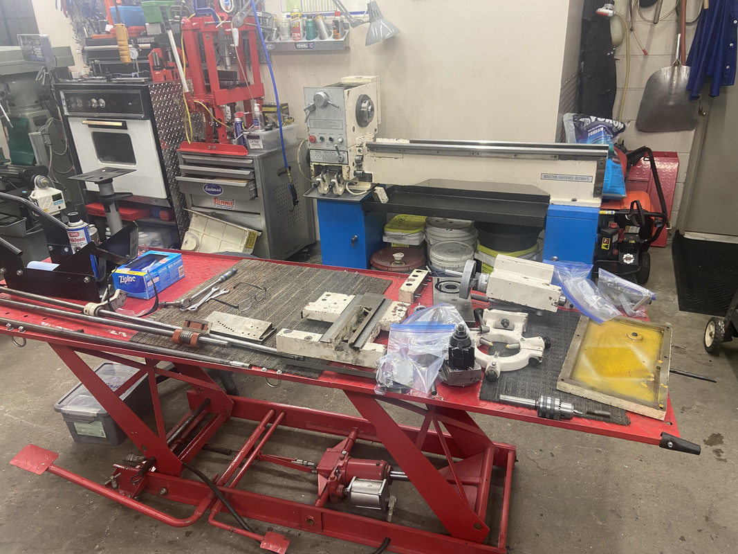

I have not been able to get my carriage drive to reverse and the cross slide power drive never did work since I bought the used lathe years ago. I decided after this die threading exercise its time to get into the lathe and see what's up and fix the thing. I got a bunch of the lathe stripped today and it looks like the gear box is the source of the longitude travel issue, a very ugly gear, hopefully I can find a replacement.
broken teeth, not pretty
taking a screen shot
My lathe is the same as a Grizzly 10" x 36" gear head lathe (many different name tags on this lathe by various distributors).
I haven't got into the carriage yet to see why the cross slide drive is not engaging.
Always something to fix, I wanted to clean up the lathe anyways so this is as good a time as any.

Thanks Mike,
I got the gear box tore down, four gears needed, lucky Grizzly has them all in stock. I know why the left hand feed position pin would not budge
the power cross slide does not work because the gear on the cross slide lead screw is missing!, again in stock at Grizzly. Why would anyone have removed the gear in the first place ??
This lathe comes with change gears that are swapped for the various metric pitches and then the positions of the quick change gear box are set to the corresponding pitch chart. On my old Myford ML7 if I cut a metric thread change gear swaps were required and I had to stop the lathe and reverse it, could not release the 1/2 nuts as the manual said the thread indicator could only be used for imperial threading. With this Chinese lathe I don't know if that applies, supposedly I could just try backing off the lathe and follow the thread indicator dial to re-engage the 1/2 nuts, that would be nice.
My lathe is a Grizzly is a G400 3G - 12" x 36" Model, anyone know if these are built as metric or imperial machines? not hat I would know what the difference is or why it matters.

I take my hat off to you Jim. If I ever learn half of what you have forgotten I would be a happy man.
Those teeth have had some "abuse". :shocked: Power fed the toolpost into the headstock?
