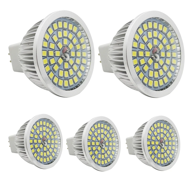

Offline Arctic Fox
  • Posts: 331
  • Location: North
Re: Extra lights
« Reply #25 on: February 18, 2021, 10:05:28 AM »
You could install those. You absolutely want a switch and relay (and fuse), AND a voltmeter. You did not say what bike you have, but most models, other that the CARC models, have marginal charging systems. They may only have enough 'juice' when rolling down the road over 3500 RPM. A voltmeter will let you know.
Many years ago I came up with a device to dim my 55 watt lights, if the charge voltage was low. Going down the road , the lights were at 100%. Stop for a red light, or slow traffic, and they would dim. I still have that device on my bike (an EV), but now have LED lighting. The lights seldom need to dim because I always get good charge voltage.
You can get pretty good LED lights for under $30 off of Amazon. A 10 watt LED, will make about the same light as a 55 watt incandescent.
Yes, there seemed to be many suitable 8W - 10W LED lights. Even different kinds (MR16 GU5.3). I see the point. Yes, wise choice for price of cost.
After all these were good choice ... I can easily change the light (if/then needed)? In some LED lights ... as those are gone, they are gone.
Offline Arctic Fox
  • Posts: 331
  • Location: North
Re: Extra lights
« Reply #26 on: February 18, 2021, 12:48:12 PM »
These are all 10W (LED) but looks bit different ... any idea which could work best?

The two major selection factors are color temperature and beam spread.  For instance one of those bulbs has a color temperature of 3,000K (Kelvin) which is more of an Amber and is great for conspicuity but not so much for illumination.  Daylight color temperature is about 4,500K which is best for illumination because that's what the human eye is evolved for.  If you want a Spot beam illumination ahead of your headlight then you want a narrow beam angle, 60 degrees or less.  If you want more illumination to the sides then you want a Flood beam of 120 degrees or thereabouts.  The integrated reflector is the primary determinate for beam pattern.
Another selection factor is input power: more power means more lumens (illumination intensity).  10W is about the same amount of power as your turn signal bulb.  From a wiring perspective, you can easily go double that.  But from a heat perspective the bulb might have a shorter life in your sealed housing.  But you will be riding 10s of hours rather than illuminating a garden for 1000s of hours so I would get the most powerful bulb you can with the color temperature and beam pattern you need.

Arctic,
I've got the smaller m11 sized lamps on my Italjet, and can offer some comments.
First, it seems like you got a great deal. My Kuryakyn Small Silver Bullets cost over twice as much I recall.
I am running 35 watt bulbs and find the lamps are mainly useful as warning devices. I have a cunning relay set up so that I can flash people about to enter the road in front of me, using my original, stock headlamp flasher lever. I might as well have a death ray, it's that effective! (The lamps are angled slightly out to either side.) My lamps really don't provide enough illumination to help much directly ahead or even to help much looking for deer off to the sides.
Your lamps are definitely 50 watts each (contrary to their being listed as five watts) enough to demand their own separate circuit and fuse. My lamps are wired so that I have an option of having them on constantly or else standing by to flash with the high beams. This required the use of two relays. Some kind of voltage monitoring is a very good idea. I use a small LED voltage indicator from England that takes up hardly any room on my dash.
I'm also a great fan of the FZ1 Fuzeblock, which I have installed in my Griso. But it may be overkill if you don't plan to add many accessories to your bike.
Here's the link to the lamps you bought, for those following along:
http://vi.raptor.ebaydesc.com/ws/eBayISAPI.dll?ViewItemDescV4&item=173004045826&category=178022&pm=1&ds=0&t=1612971547000&ver=0&cspheader=1
I had great fun thumbing through the Romano Motorsports pages -- reminded me of the old Warshovski catalog out of Chicago.
Let me know if you want a circuit plan like the one I described. Good luck!
