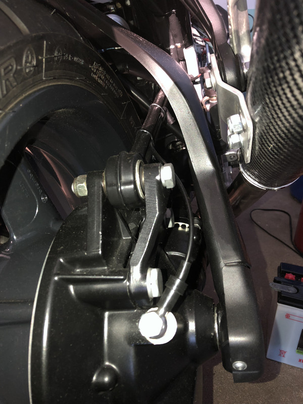

Today I finally installed a remote vent on the V7 rear drive.  It's dead simple, M10 banjo bolt with barbed fitting, 1/4" polyethelyene tubing routed under the tank.  I'd rather have black tubing but....gotta use what is on hand..

Online SmithSwede
  • Posts: 2116
  • I don't want a pickle
  • Location: Dallas, Texas
Re: V7 III water in final drive oil
« Reply #35 on: May 03, 2020, 11:50:56 AM »
Pyoungbl: that looks really slick

  • Posts: 4289
« Reply #36 on: May 03, 2020, 12:52:10 PM »
Looks good!  I will need to do that myself one day.
Looks good.  Can you please tell me where you got the barbed banjo fitting?

https://www.ebay.com/itm/TRITDT-Banjo-Bolt-Kit-M10x1-5mm-w-1-8mm-Hole-SUBARU-TD04L-RHF5-Turbo-Oil-Feed/222595676853?hash=item33d3bc7ab5:g:QikAAOSwtnpaHRPr
this is the one but I'm sure I got it for $11. or so with free shipping but can't find the order.
paint it black and use a black vacuum line.
