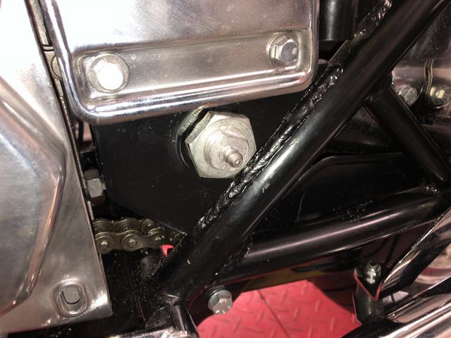

The swing arm has a large jamb nut, it was missing on the bike when I got it and Detlef Burian sent me one that is a wee bit too small. The threads are very fine for such a big thread, I am guessing 1.5 pitch? and maybe a 27mm size?? I have been searching on line for someone who caries such a big metric jamb nut, does anyone know a source for such odd metric stuff? I don't have McMaster Carr in Canada and they will not ship outside of the USA??
Measure to determine exactly what diameter and thread pitch you need and I'll see what I can find.
Thanks !
I will check when I get back home on the 29th.

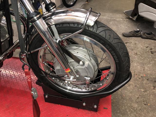

Got some time in on the Benelli today, started with fitting the new chain, I read an article in Classic Bike where Rick Parkington talks about using a chain puller to bring the two ends of the chain together. I found several on Ebay and got this one from China with free shipping for $15.00, great little tool
https://www.ebay.com/itm/25-35-41-40-50-60-415H-428H-520-530-Roller-Chain-Connecting-Puller-Holder/172623069155?ssPageName=STRK%3AMEBIDX%3AIT&_trksid=p2060353.m2749.l2649
and I fitted the chain guard, it has few dents and its split at he back but until I can find a better one this will do

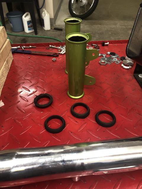

I 'borrowed' the Ceriani shocks off my Laverda SF1 while I wait on the Benelli's pair getting the hard chrome plating of the worn shafts. I like the quality of the Ceriani shocks and the hand adjuster lever cast into the lower spring retainer.
Marzocchi made the forks so I added some repro decals, I don't think Benelli ever placed the decals like Moto-Morini and Ducati did but I like the look of the decal and I think it adds a little touch to the build

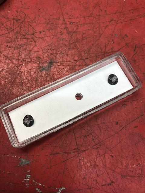

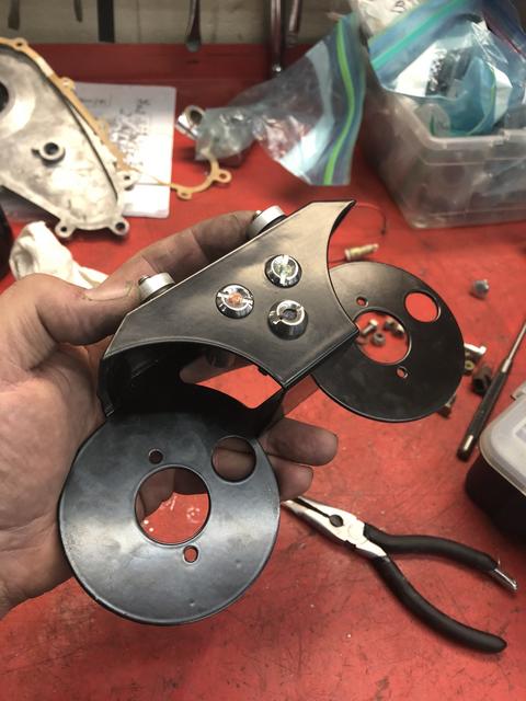

The three dash idiot light lens are all in very poor condition, Detlef sent me three new style LED lights to replace the original bulb and bezel units but I prefer the bezel of the original.
The LED is a one piece bezel and bulb, the original bezel that holds a coloured plastic disc inside
I put the new unit in my lathe and turned off the bezel and threads until the LED body slid snug into the old bezel
I had two Benelli dash boards and salvaged three bezels from the lot, the lights are similar but not identical, one having a larger aperature
A little epoxy to make sure the sure in LED stays in place
Three refreshed idiot lights installed and wired in to the fuse box, the lights should be visible in the sun light, a common knock on Italian bikes of the period that as the poor dash lights and equally poor gauge accuracy.

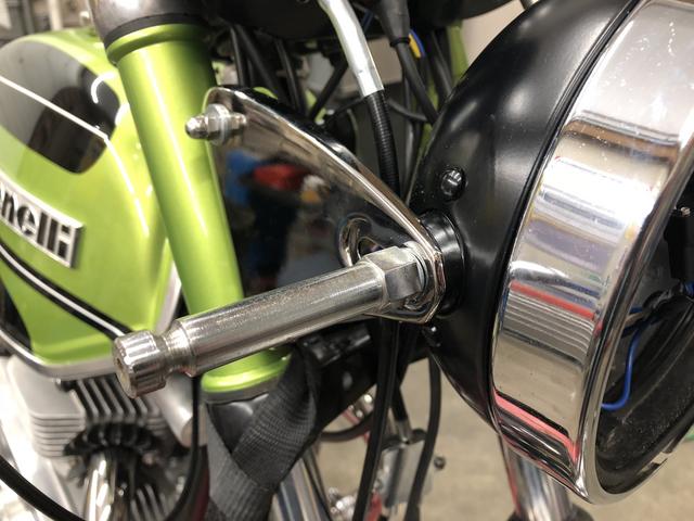

I have to get some stainless solid bar and turn up a pair of front signal light stems with a threaded end to screw into the headlight bucket, the lamp end will have a 1/2 ring cut out to take the 6mm pinch bolt passing through the signal light body. seems these CEV / Benelli front signal light stems are unobtanium.

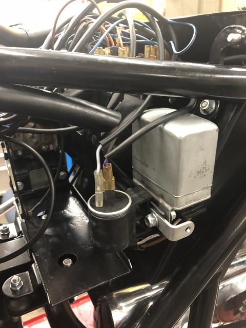

The wire harness kits Detlef supplied are great but there were a few components missing: the starter button harness, light switch harness and the signal light harness.
The starter button is just two lengths of brown wire, one end to the fuse box with the ignition 'on' side of the box and the other end to the starter relay.
added some pvc sheathing (I get it from British Wiring in the USA along with multi-colour wire and crimp connectors)
https://www.britishwiring.com/
A zip tie and it should start when the button is pressed

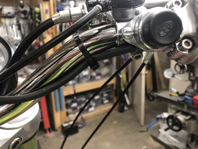

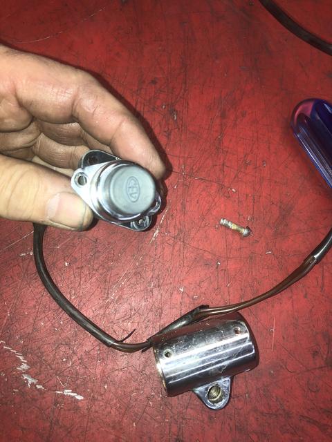

Benelli used a common CEV signal light switch on the left handlebar, I found a new one on Ebay
Again this CEV switch has machine screw wire fastening, nice touch, and its labeled Left (S) and right (D) Big chunky switch, should be easy to use
Now the CEV light switch is another beast altogether, I have ruined these in the past trying to solder wires to the brass lugs. I use electrical conductive epoxy, its very pricey but you only need a couple dabs
The original switch on the left had the power wire from the flasher re-soldered and the plastic melted and warped the connection, ruined!
Just a couple more electrical jobs to make up the signal light connections and to connect the brake light switches, hopefully all of the electrical will work.

Benelli Bauer found me a pair of front signal light stems and the rear brake pull rod, the last two hard to find parts I need!

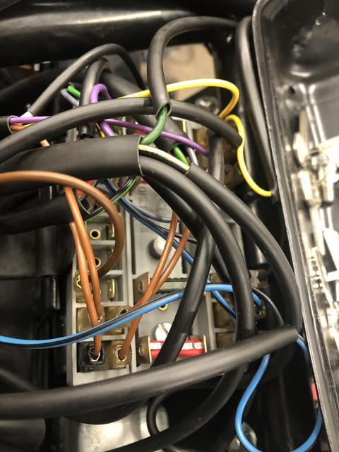

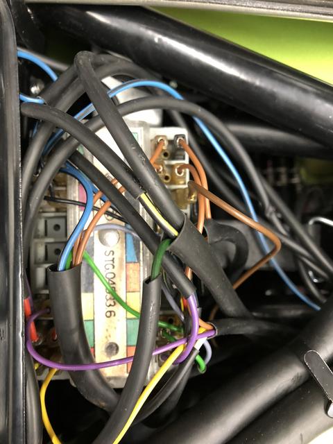

I finished with the wiring today with the exception of hooking up the front signal lights once the stems come in from Germany.
Spaghetti junction like the Moto Morini the folks in Pessaro chose to use individual wire harness components for each system, it seems busy but the more I work with this type of electrical the more I like it, easy to install, easy to trace faults, no big multi wire harness to contend with. The Benelli Tornado use the same type of CEV fuse box as the Moto Guzzi V7 Sport and the Moto Morini 350 / 500 twins.
For the rear signal lights I used a modern single wire quick connector
Foe the signal flasher I used a Moto Guzzi rubber flasher holder and just slipped it around the bracket that carries the regulator, looks like it could have been stock
The conductive electrical epoxy set up over night so I could finish installing the light switch and hook up the final headlamp connections

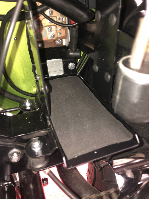

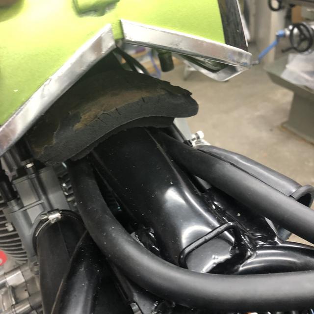

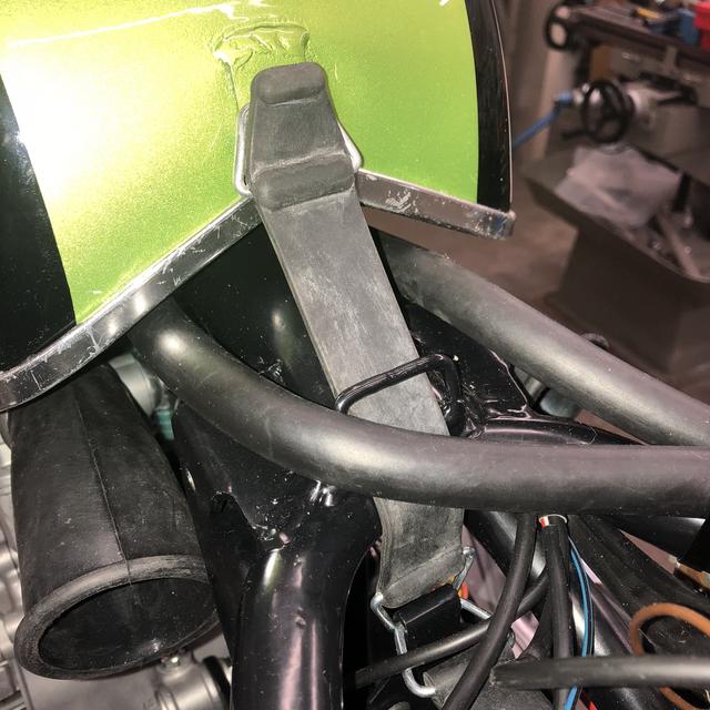

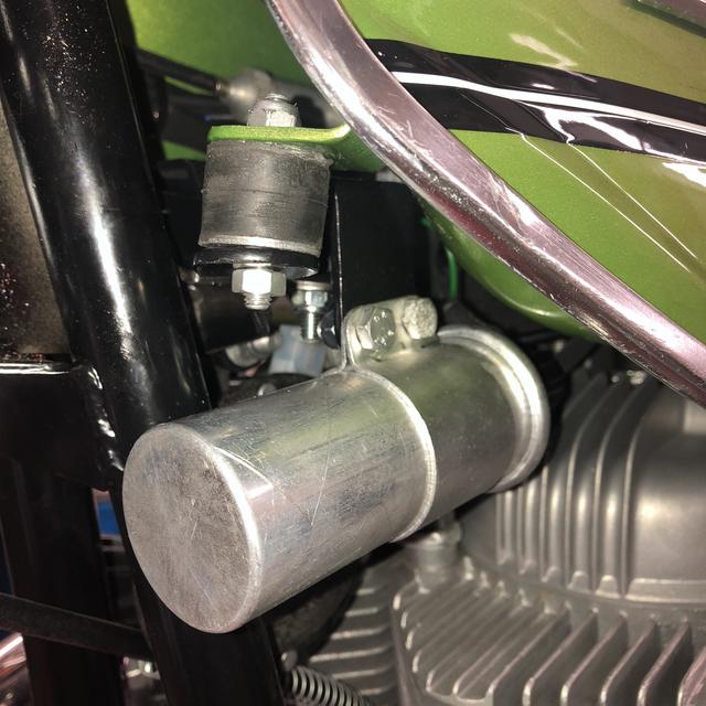

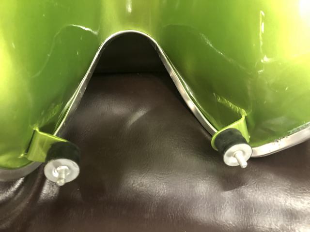

Silent block fitted to the front of the gas tank
I saved the original foam tank pad, need to glue it to the underside of the gas tank
And the tank strap now in place

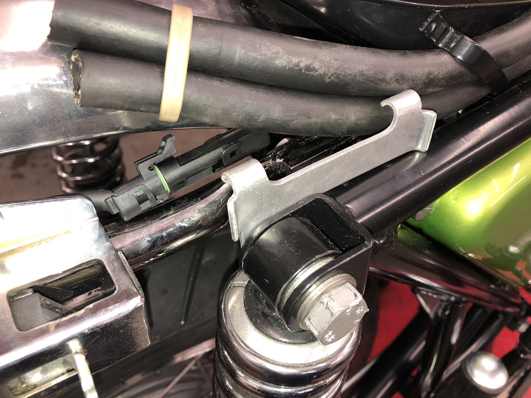

Installed the used vent hose rubber clip

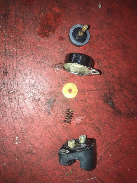

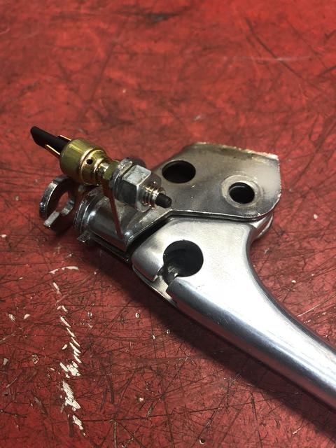

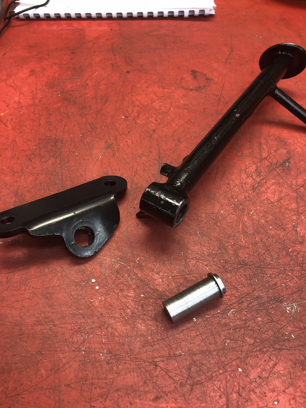

I need to remove this little tab from the old brake lever perch and braze it onto the new perch, this tab holds the front brake light switch
Should have noticed this before I installed the brake lever
This is how the perch / brake switch looked when I got the bike, there is a cylindrical stud that fastens into the round cable recess under the brake lever and makes contact with the brake pressure witch, pull the brake lever and the switch plunger opens and the brake light comes on. I was wondering what that strange stub in my parts box was for!
This is also the same as the early Morini 3 1/2 Sport set-up. If you need a switch, Magura makes one that works perfectly, I bought it on Amazon for $12.

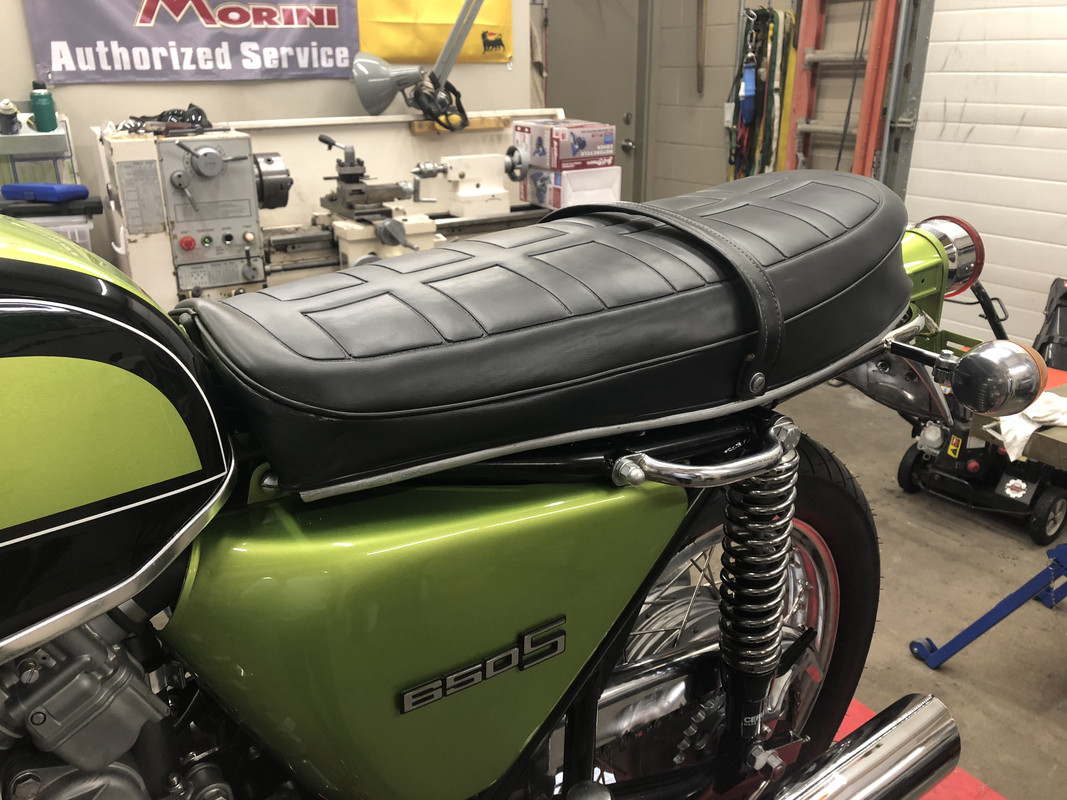

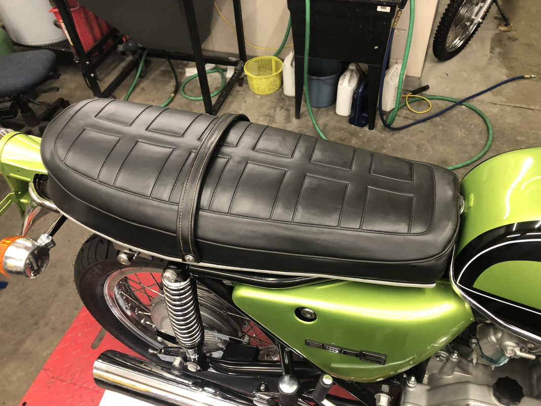

The upholstery repair shop just delivered the restored Benelli seat, I think they did a great job.
the torn front area was reinforced from behind with a very durable mesh fabric, all the holes patched from behind, vinyl stained black.

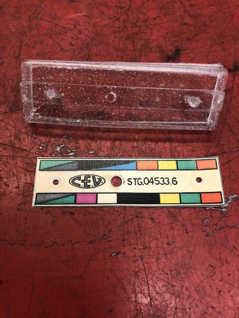

The shop did their best to replicate the chrome plastic band, not the shine of plastic chrome but a heck of an improvement on the raw green plastic.
If anyone knows where to find the CEV tail light red reflector inserts please let me know.

Benelli Bauer came through with a swing arm jamb nut
And he also sent me a new rear brake pull rod, a real nice used chain guard and this pair of NOS front signal light stems, they still had the part label on them
Glad I didn't have to make up a facsimile of these

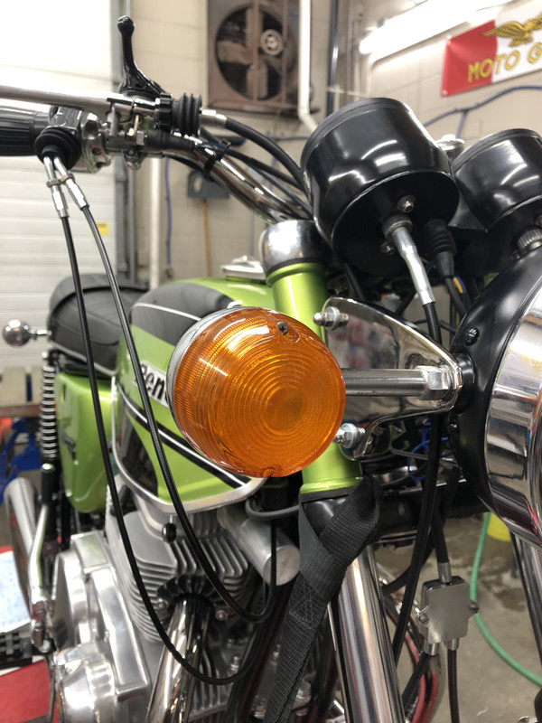

and the restored cast aluminum signal light body clamps over the stem
Now I can finish off the wiring

Finishing the signal lights, 1st to drill out a broken off lens screw, 4mm x .75 tapped
Terminate the wires, add a ground wire to each lamp body and the lighting is done.
Heated up the broken brake lever perch and melted the silver solder to free the switch tab and brazed the old tab onto the new perch
Brake light switch in place

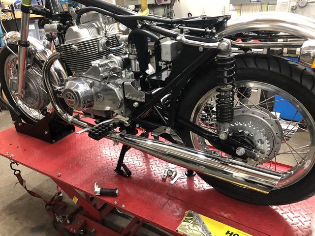

And fitted a pair of new petcocks with the clear sediment bowl, similar to the original type used by Benelli but not an exact match, the male hoase nipple is a lot smaller O.D. than the fitting on the carb, need to figure out what to do about that to make one size of hose fit a small and large nipple at the same time ???
I tried to fit the brake pull rod that came in the mail
But the brake lever arm I got a couple months ago does not fit the splines of the rear brake cam shaft that is 13mm
The arm I have is only 10mm, must have been for a smaller Benelli
Looks like the brake arm on my 72 Moto Guzzi has a 13mm spline and the arm looks like it will work, I know I have one in my Guzzi stash

Moto Guzzi parts to the rescue! The Guzzi Eldorado rear brake arm fits onto the Benelli brake plate shaft and the shape of the Guzzi part works with the Benelli geometry.
Benelli fitted this little steel stud with rubber cushion as a brake pedal stop, nice detail.
And under the seat attached to the shock upper mount bolt is this simple helmet hanger that secures the helmet once the seat latch is locked
The To Do List is getting pretty short;
clutch lever (Wolfgang Haerter is supplying one),
install clutch cable,
install headlight,
side reflectors (still looking),
install side stand (coming form Italy - I hope..),
weld a tab onto the centre stand,
get a key cut for seat latch,
replace points and condensers,
adjust valves and install rocker cover O rings,
check the electrical,
fill the engine with oil,
add gas,
cross fingers,
press start.

I was not able to find an original rubber battery tray so I opted for a battery mat from MG Cycle, just trim to fit with scissors and peel off the paper over the self adhesive backing,

And the side stand came in from Italy, the bracket was with the bike but the pin that the stand slides over was broken off.
I made a new pin out of steel stock in the lathe and cut a groove for a circlip like the original had
Now to just weld the pin to the bracket and give it a shot of black paint + find a side stand spring that will work
Couple more jobs off the list.

A new clutch lever came in the mail Friday from Wolfgang Haerter in Nakusp B.C.
The new clutch cable I got from Germany does not have the correct end for the lever, this will have to do for now until I find another cable
The cable winds its way around the left side of the motor passing through two cable guides
Then through the top of the crankcase passing through a lug before ending at the clutch arm and a pinch fitting holds it in place. finished with a little rubber end cap silicone in place

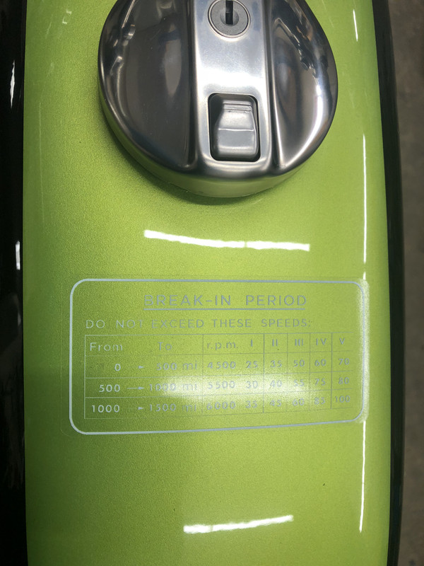

I scanned the break in instruction out of the owners manual and had a repro decal made for the tank, its the same size as the decal that was on the tank, handy
Glare from the lights overhead and the camera makes the decal hard to read in the picture, it actually looks fine on the tank
Just waiting on the tiny Made In Italy decal to come in the mail, the tri-colour decal site behind the break in decal and finishes off the job.

a small detail hardly anyone will ever see, the CEV clear plastic fuse box lid is almost always missing or broken. Eurortrash Jambalaya sells complete CEV fuse boxes on Ebay and a clear lid can be taken from a new one but a couple years ago I tried casting my own copy with a latex mold and clear urethane, its very hard to get the air bubbles out of the resin in the mold without a vacuum chamber, the results are just OK and since this part will not be readily visible it will do. I photocopied the CEV coloured card from my V7 Sport fuse box and laminated the colour copy to a thin card board.
A couple retainer clips to hold the colour card like the original system
Air bubble not as noticeable when the colour card is mounted inside the cover
And back in its final position under the seat
I adjusted the valves, fitted the rocker cover O rings and set the points, finished the fuel lines, just need to add oil to the engine and forks.
« Last Edit: January 02, 2020, 02:05:07 PM by canuck750 »

Very cool that you cast the fuse box lid yourself! I think a quick and dirty vacuum pot could be made of a strong paint bucket and a ejector style air fitting. It will obviously not be able to pull down to -0.9 bar or something like that. But I think it would be possible to pull the airbubbles out with less. Might be worth a try. A piece of pipe with ends closed could also be used.
I do agree though that the air bubbles are not so visible when the colour card is in. And it is under the seat, so it would probably not be worth fighting with.
