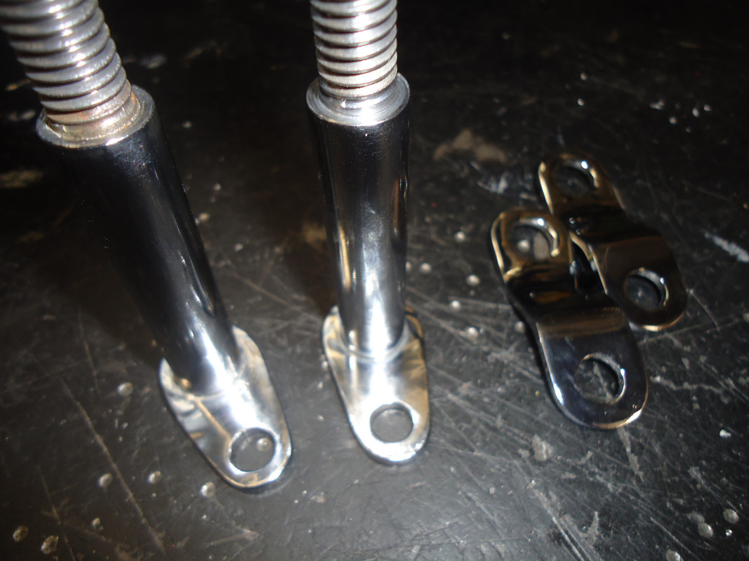

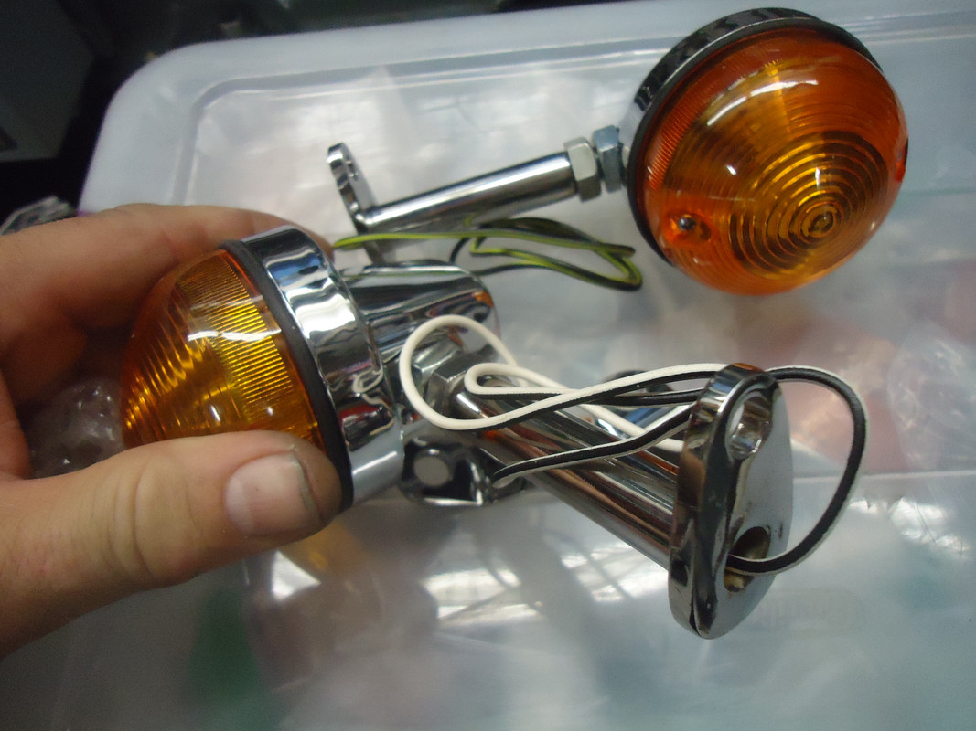

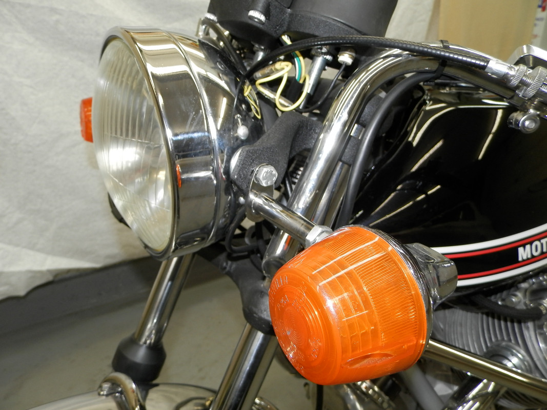

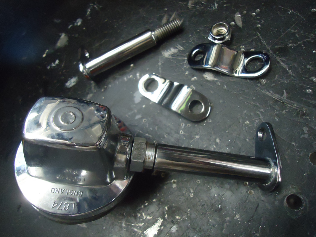

Out of curiosity, roughly how much was your restoration. I will hopefully begin a restoration on a V7 soon.  I need to know if sending my wife for a trip to the spa will suffice, or if i am sending her on a Caribbean trip before telling her how much $ i am going to spend on restoring the bike.
My step dad owns a 1972 V7 Sport, bought it new.  Hes all ready said that when he passes away, It will become mine. Unfortunately / fortunately, it doesnt look like hes going anywhere soon.
Sadly the bike has been parked for 15 years, It was running great when he last used it. But now it definitely need some love.   I am trying to sweet talk him into giving it to me now.  I plan on doing a full restoration. Paint, chrome, Motor.... The works.  Getting raid of the honda fairing he installed way back when is at the top of my list.
Also, any leads on where I can get a light bucket and turn signal for the bike? That would be greatly appreciated. After nearly 50 years.... His are long gone.

I restored mine 30 years ago, my costs are not relevant. However, your chrome costs are likely to exceed the cost of sending your wife for a spa!  :grin:
That is a solid, unmolested example, restoration will be relatively easy. Do not throw away those rear shocks, they are rebuildable, have the shock rebuilder set them to full hard damping while he has the springs off. Also, warn the plater if you send the bottom spring collars for replating, that they are zinc, use the correct stripper or he will dissolve them!
Start now, some parts are getting hard to find, where on here did I see a reference to buying V7Sport Gilardoni barrel kits, they are hard to find right now, & you will need a set, the chrome will be knackered. The Silentium mufflers will probably be unchromable, start looking for new ones, or Lafranconis while they are still around.
The headlight bucket is same as a Benelli 650 Tornado, start looking.  :laugh: They turn up on fleabay, be prepared to send your wife for another spa!
It looks like 2 of the indicators are still attached to the Craven pannier rack. They were Lucas.

As far as signals - the US V7 Sport used Lucas signals. Jim Carey (cunuck750 here) sent me a bunch of "tabs" and I made my own mounting stems for the front, then had them chromed. https://flic.kr/p/2i8bxVH . The rear mounting brackets are just a zig-zag piece of flat steel, reproductions are available from MG Cycle. https://flic.kr/p/2i9Gn5p . New Lucas signals (genuine or reproduction) mount differently than the originals, so I tapped the plastic bodies to 7/16"-14 as original, drilled studs hollow and used s.s. nuts and washers.

I made up a batch of reproduction front and rear V7 Sport signal mounts / stalks, I have extra water jet cut tear drop tabs that you need to weld a hollow tube stem to for the front and tap it for the light stub, also have water jet cut rear tabs the you fold in a vise, if you can use the tabs pm me and I will mail you some
