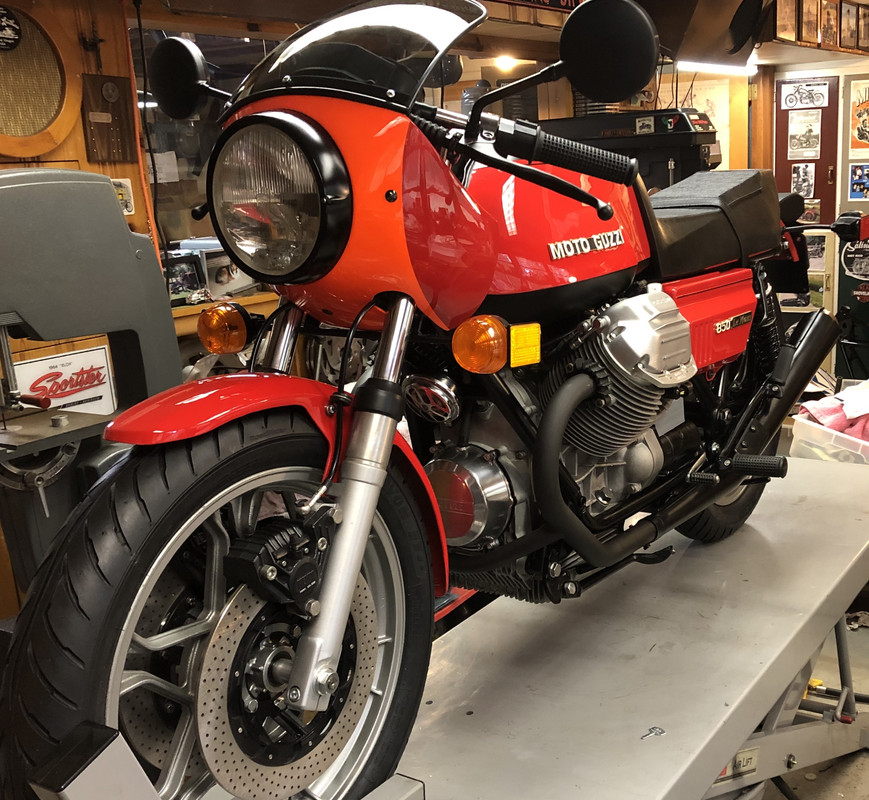

Here's a summary of work done.
ENGINE
The engine was partially disassembled for inspection and found to be in very good condition.
Rear main seal replaced, and gave the exterior a detail.
CLUTCH
Replaced clutch and upgraded to the deep spline.
TRANSMISSION
Disassembled for inspection and found to be in good condition.
Rear and front main seals replaced.   Front seal had been leaking.
DRIVELINE
U-Joint replaced and all spline drive shaft and couplings.
U-joint carrier bearing replaced.  The bearing felt rough and upon removal found the inner race had 3 cracks.
Rear drive spline and mating drive spline on rear wheel replaced, along with new cush rubbers.
BRAKES
All 3 brake rotors were refinished by TrueDisk.
All brake pads replaced with "best" Brembo carbon ceramic pads.
New front master cylinder rebuild kit.
Brake lines replaced with black steel braided lines.
MISCELLANEOUS
Damaged instruments repaired by Palo Alto Speedometer Service
Damaged instrument cluster housings replaced
New wiring harness from Greg Bender.  A thing of beauty!
Fresh paint by PaintWorks.  Craig did his usual amazing work including the satin black finish on the fuel tank.
New exact reproduction seat from Guzzibits.
All rusty hardware was zinc plated at Manner Plating (local).
Fresh Avon AM 26 RoadRiders and converted to tubeless.
Fork seals and many other rubber bits replaced.

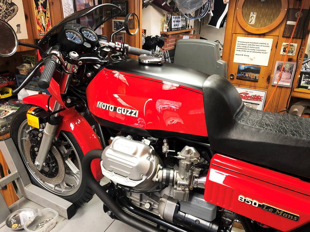

Playing around with Iphone camera.
