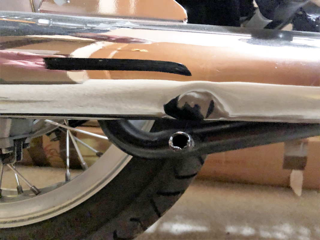

Bummer about the blemish, but it wont detract from this awesome bike.

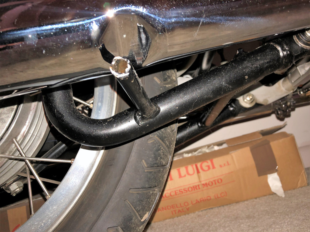

He's been watching the Flickr photo album and seems pleased except for the blemish on the left muffler. He wants me to have it rechromed, but then they may not match. Not to mention, that so far, all three platers I've checked with have quoted me about what a new one (if they were available) would cost. Should have bought the LaFranconis when we had the chance...
