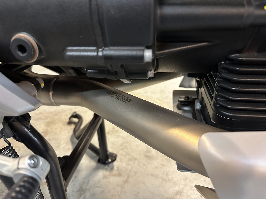

Hey Guzzi folk.
I recently bought a 2022 V85TT. (Great bike)
I'm nearly done farkling, but I'm now eyeing a Mistral exhaust system, including headers/y-pipe as well as one of their slip-ons.
My goal would mainly be to make maintenance a touch easier (looks like a pain to drain the gearbox with that big cat in the way), drop some weight, and most important, get some better music coming from the bike.
For anyone who has done this, am I in for a can of worms if I replace the stock exhaust system? How bad is the decel popping? Am I gonna have to install a SAS delete kit or do the ECU remapping dance?

I finally received my mistral system. Looking to install it this weekend and will report back on this thread.
One question for anyone with an E5 bike, though—Any advice on how to get to the lambda probe connectors? Looks like access is pretty tight next to the reg/rect unit. Looks like you might be able to detach the connector but it’s pretty stiff, don’t want to break it.

It's been awhile since I installed mine.  The instructions were pretty good.  It was quite easy, therefore the foggy memory.
Do you recall if you had to remove or loosen the R/R or lift the tank? I'm seeing conflicting info online and the shop manual is no help. I think the reality is I just need to lift the connectors up off its mounting bracket.
Funny how I'll tear down my G5 or T3 with no issues but a little electrical connector on a modern bike is causing me grief.

« Reply #17 on: July 08, 2023, 11:48:24 AM »
Got it installed. I did loosen the R/R to reach the lambda connector mounting post.
Very happy with the sound with the dB killer installed, and very happy to lose some weight. Not to mention easy access for gearbox oil changes.
Now just need to go on a long ride to see if there are any discernible performance changes.
