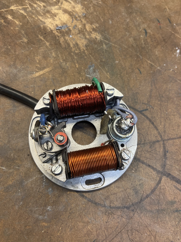

I need help sourcing a rear brake light switch for the Gilera 106 SS, this is not a typical push or pull type brake switch
The brake light switch for this bike is interconnected to the stator ignition coil circuit, energy transfer ignition, no battery, 6V AC.
The stator coil for the ignition sends 6V AC power to the points / condenser / 6V coil from one end and the other end to the brake light stop switch. When the brake pedal is NOT pressed there is a rera brake switch connection to frame ground, this completes the ignition coil ground, when the brake pedal is pressed the brake switch ground connection is shunted and ground flows through the stop light to frame ground.
If the brake light bulb is burnt out the engine will die when the brake pedal is pressed.
The Sears parts manual lists the brake light switch as 45788. No idea if this a CEV or Aprilia unit, the stator is CEV.
I am told dome Ducati singles with energy transfer ignition (no battery) used the same system.
any help much appreciated.
Jim
Sears Gilera 1#06 Ss parts page
The stator, lighting coil on Left, Ignition / Stop Light coil on right, note the right hand coil is not grounded to stator body whereas the left hand coil is
Last Edit: June 22, 2022, 05:32:35 PM by Canuck750

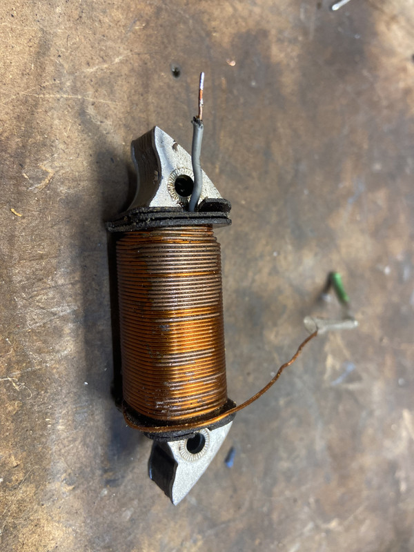

July 17, 2022, 07:33:23 PM »
The little Gilera has put up a good fight to remain dormant but after a lot of trouble shooting and repairs I got the might 106 SS to fire up on the second kick. I just could not get a spark (intermittent at best) and after disconnecting all the connections unrelated to the ignition, swapping 6V coils, high tension lead etc... I settled on the stator ignition coil having intermittent short, running an ohm meter probe across the surface would expose a short from the pressure of the probe.
I had a couple spools of fine coil wire that I never used so I removed the coil and stripped the seven windings off the frame. It ain;t pretty but I got seven full wraps and the spark is strong and steady.
Stator back in the bike, rotor torqued down, fuel bottle connected to the carb and with two kicks and just a touch of the throttle and it fired right up, hurrah! I ran a dedicated ground wire to the brake switch terminal fed from the stator to complete the ground circuit of the ignition coil.
