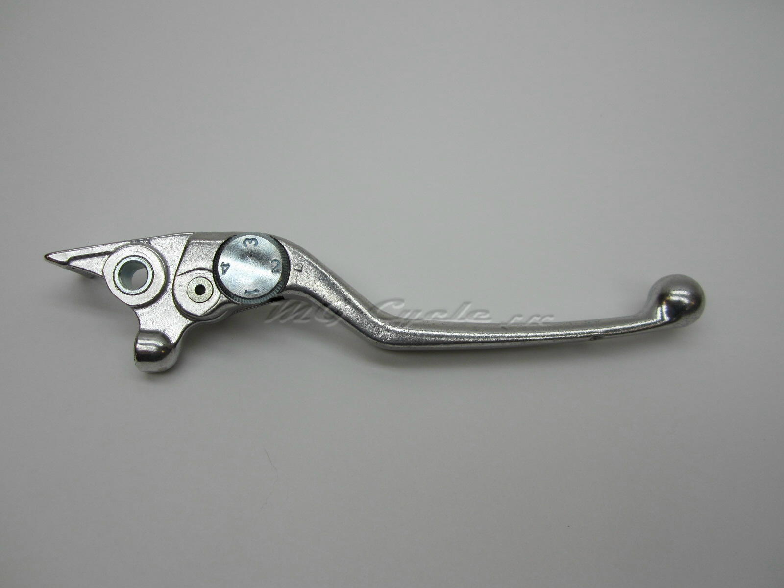

Online sign216
  • Posts: 4831
Re: 750 Breva gear change
« Reply #10 on: June 22, 2019, 09:44:22 AM »
I went with these levers, clutch and brake, from MG Cycle.  They're economical and drop-in fit.  Made by Domino (I think), just like the OEM.

Offline antmanbee
  • Posts: 903
  • Location: N E Florida
« Reply #11 on: June 22, 2019, 09:49:37 AM »
Brian, one of the best things I did was get a pair of levers off AliExpress, adjustable, foldable, extendable and done in matching red and black bits almost exactly the same red as the Breva.  All done in CNC'd 6061 alloy.  The shape of the lever is that when it is pulled in the lever follows the handlebar exactly  and gives just that bit more cable travel.  I have very short fingers and have the lever adjusted as close to the bar as it will go, and still the clutch disengages perfectly.
Best $44-00 I ever spent on the bike, and I got the pair for the same price as one muck metal Guzzi lever.
Could you link to where you bought them and post a picture or yours too? Thanks
Online bmc5733946
  • Posts: 800
  • Location: East Lansing, MI
« Reply #12 on: June 22, 2019, 10:27:39 AM »
Since my wife was the primary rider of the Breva and has small hands, I used an adjustable lever from a Centauro which fits. I found the clutch slipping on a spring test ride. I started investigating the adjustment problem,  I was not able to find any lever that had more than 19mm of cable travel at the lever end. Muzz can you measure the cable travel available with you levers?? Iam very interested!!!!
