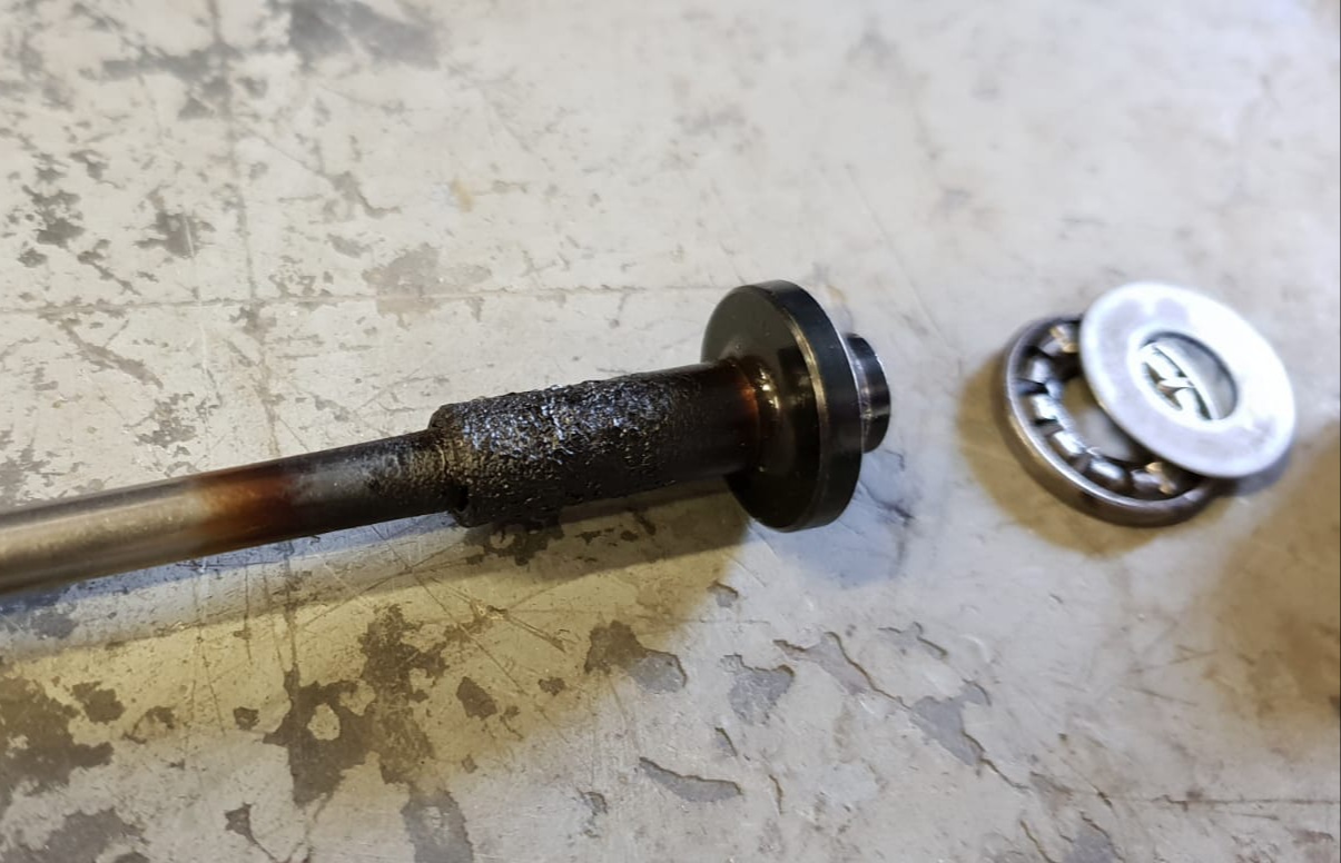

I had the same issue as you, constantly adjusting lever play, losing disengagement, and on hot days I could only shift and find neutral while moving until it got so badf I was just shutting my bike off at red lights.
I ended up having to replace my clutch rod and throw out bearing, the washers and bearing were basically disintegrated when I took them out. No problems since.
https://www.apriliaforum.com/forums/showthread.php?326857-V7-Clutch-Rod-and-Throw-Out-Bearing-Replacement

This is what I was hoping for an explanation and solution  :thumb:
The screeching noise is the bearing you see.
I wasn't sure if you could replace the throwout bearing without unbolting the gearbox..
Take the opportunity to give the drivetrain a good lube with Moly grease.

Yes, that pivot on the clutch arm can seize. That on my 2014 had only a restricted amount of movement, and was a real bugger to get out - those lugs on the cover require care in the application of force, even with the gearbox out of the bike. Cleaned it up, had the pivot machined smooth & it's now back in.
The thrust bearing/throw out bearing can be removed without taking the gearbox out, as per AF1's tutorial. It's a great deal easier with the swingarm removed. The outer body can be easily pulled out, with only a little reluctance from the o-ring. A magnet on the end of a stick can extract the thrust bearing. Note AF1's photo of the new & old components. The old-style bearing has cupped washers, and the new has flat ones. The new one is supposed to be more robust. At least here, Guzzi appears to be paying attention to detail.

Hi everyone, sorry for the late follow-up.
It took a while to get the parts & find someone to work on the bike. However, I'm happy to report that replacing the following parts, as suggested, seems to have fixed the problem:
- Needle Roller Thrust Bearing (2A000376)
- Clutch Push Rod Inner Body / Cap (GU14086000)
- Clutch Push Rod (GU20085720)
I ended up purchasing the kit from AF1 (https://www.af1racing.com/OEM-Moto-Guzzi-Clutch-Pushrod-wBearing).
Thank you all for the replies & suggestions. Happy to be riding again!
