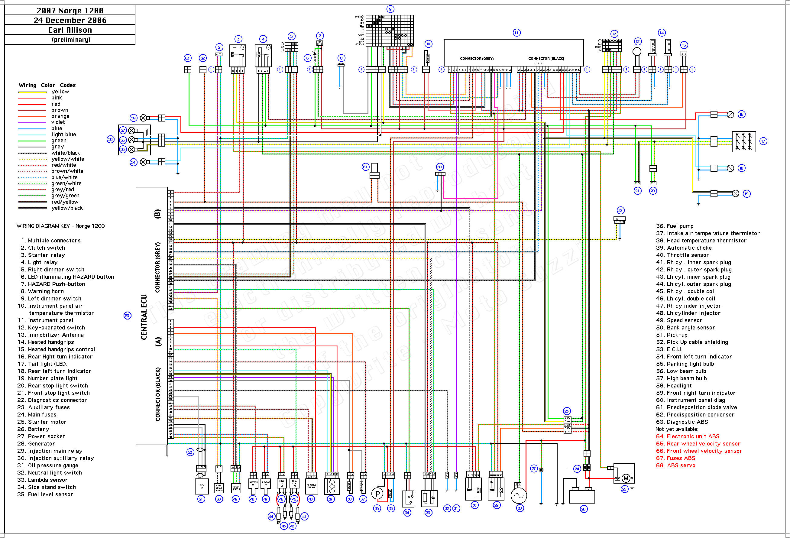

it sounds like you are running again, congratulations
my wife was watching an Australian cooking show when i fired up your video, much cheering from the TV
in a situation blowing fuses the pump is powered up alone when you turn the key ON it only draws about 5 Amps normally but will draw up to 9 with the outlet blocked, still shouldn't blow the fuse.
its only later when you crank the the injectors and coils fire up
if anywhere on the red wire is grounded of course the fuse will blow.
https://www.thisoldtractor.com/guzzi007/schematics/2007_Norge.gif

I've just looked at the wiring diagram tha Roy put up and spotted something.
The 15A fuse amongst other things seems to feed the speed sensor too.
My old 05 B1100 dropped dead the morning after I'd been riding in the rain, and after a 3 month marathon of checking and much frustration tracked it to the speed sensor shorting out.
If you're initial thoughts don't bear fruit have a look at the speed sensor,  but bear in mind it might be drying out and giving you a false sense of security.
Good Luck

Well.
Had another bout of trouble involving triangles of death and complete stoppage in city traffic.
Pushed the bike 1.2 km back to the Hotel and spent a sleepless night wondering how it would all pan out. The battery was going flat and all sorts of warnings were going off…I think I got a 1202 alarm, so must be circuit boards from the old Apollo stock…!
Anyway, I went out in the morning to see if the bike would start or did I have to walk to the shop for my new battery which I was sure was rooted.
Pushed the button and she fired..!
Once I got to the shop I purchased a new battery and disappeared off for 4 hours while it was being activated and charged. I would have liked to follow Pete’s tutelage and let the acid soak into the mat, but they were closing and I only had the 4 hours.
So while I was preparing the space for the battery I happened to turn over a fuse block and I saw this….
I don’t know if burning plastic insulation and blown fuses would contribute to unreliability issues, but I’m going with it for now… :rolleyes:
Anyway.
It’s because I moved the small fuse box from the back under the seat to free up some space and displaced the (now) affected one to a less suitable spot, the insulation had become non flexible in the warm under seat environment and split, allowing the bare wires to rub together with predictable results…
I’m lucky I didn’t set fire to the poor bugger…What a tool…!
So tomorrow it will be an easy fix to strip the wires back a bit to the good clean stuff and locate the fuse block properly, I am with Francois who lives in the countryside in Auvergne.
Except for the blown CARC which I don’t think you can pin on the bike as such, I have never had an issue with the Norge that I did not contribute to in some way.
I have learned a big lesson here….
