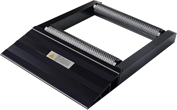

No a jack or stand is NOT necessary. Yes it is possible.
It is even easier using a wheel roller:
https://www.amazon.com/Medduw-Motorcycle-Cleaning-Roller-Motorcycles/dp/B09GB51B3D/ref=asc_df_B09GB51B3D/?tag=hyprod-20&linkCode=df0&hvadid=563620908360&hvpos=&hvnetw=g&hvrand=1026323436439691996&hvpone=&hvptwo=&hvqmt=&hvdev=c&hvdvcmdl=&hvlocint=&hvlocphy=9003815&hvtargid=pla-1595565664688&th=1
Though personally on anything with a dry alternator I prefer to remove the alternator cover and turn the engine slowly and precisely using a wrench on the crank rotor nut.
