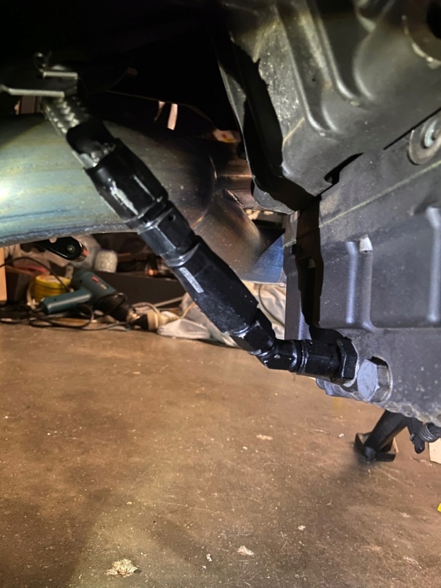

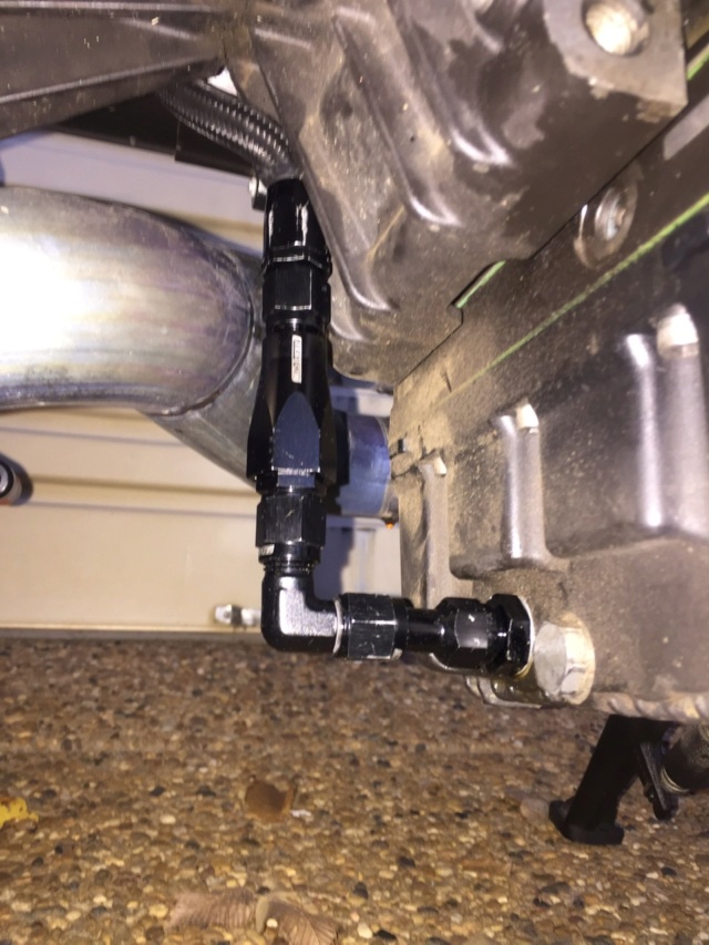

I made my own with AN fittings and nylon braided hose. Still cost less than genuine *new* part in Oz dollars.
V1
V2

I used a non-return valve as its part of the secondary catch can in the expanded blow-by system. Hence V2, as I didn't like the sharp bend on the hose where it goes up behind the throttle bodies. You don't need the valve, so you could get away with a single 90 degree hose end, AN extender and the metric adapter.
