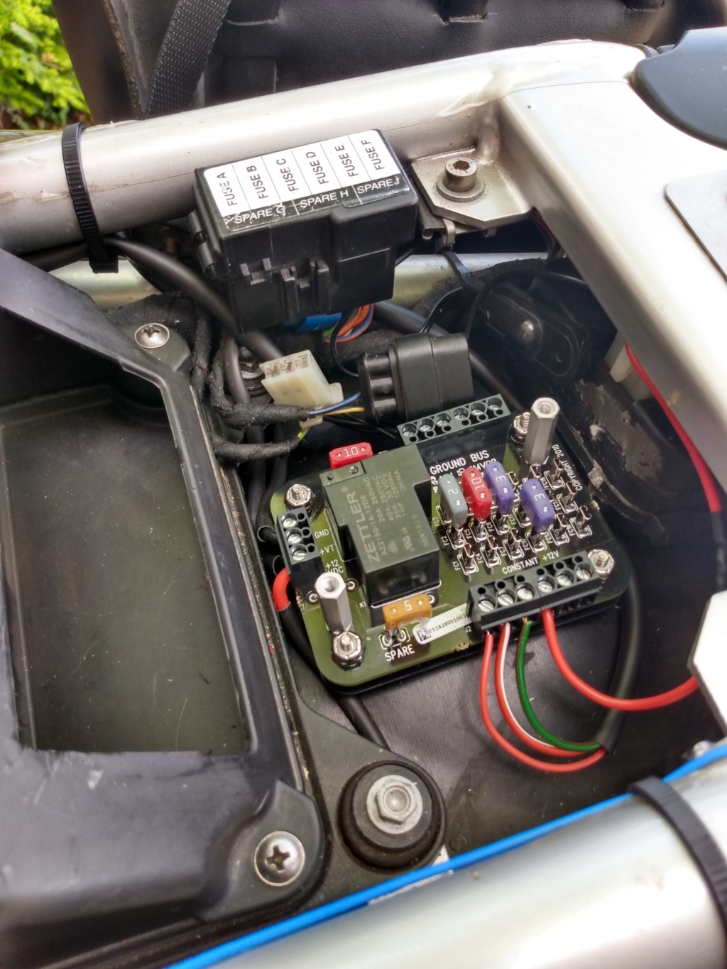

I recommend Fuzeblocks:
https://www.fuzeblocks.com/
Try searching for "fuzeblock" in earlier threads.

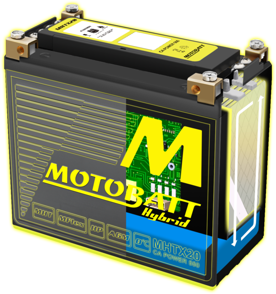

Motobatt's 4 terminals can make life easier but I like those fuzeblock stuff,

  Hard to tell from the picture , but how high is that fuzeblock with the cover on ? Peter
Online moto
  • Posts: 968
  • Potrebbe andare peggio, potrebbe piovere!
  • Location: Madison, WI
Re: Accessories for V7 or, So Many Wires, So Little Space
« Reply #8 on: May 09, 2021, 08:44:10 PM »
Mine is out of easy access right now since the snorkel of the airbox has been put back in place. The website gives these dimensions: L 3.25" x W 2.5" x H 1.25". When considering the purchase, I cut a pine block of that size for test fitting. The actual fuse box was the same size when it arrived.
The product is very well thought out. I can't think of how it could be improved within its design parameters for amperage and numbers of circuits.
Moto
EDIT: By the way, I mounted the box by gluing Velcro to it and the rear fender where it sits. This works well and allows for repositioning the box when adding new wires. So the thickness of a Velco strip (both sides) should be added to the height if you use the same method.
M.

I've had (the same ) FuzeBlock on my last 3 bikes. One, with the MotoBatt with extra terminals. Didn't fit under the seat of my 2017 Stone, so I velcroed it behind the left side cover, against the air filter housing. Ran a trigger wire from the USB port on the battery side.

+1 for the Fuzeblock. I’ve run one on my /5 for years. It has an internal relay that powers everything up when you turn on the power.  You can also switch the fuse positions to have circuits “always on” like your battery tender.
