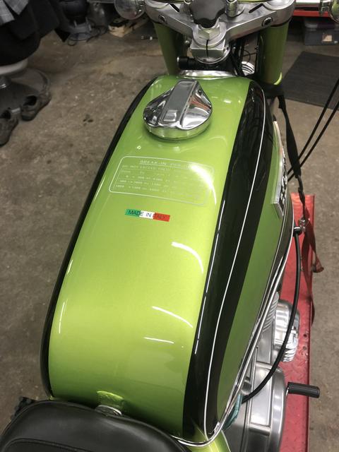

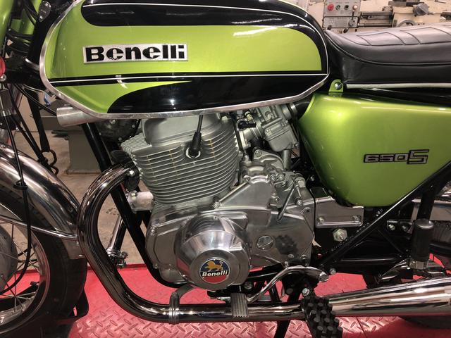

The original signal lamp lens screws were either missing or the Philips heads were mostly rounded out as a result of corroded screws and aluminum signal light bodies. Thee CEV signal lights take a 3.5mm screw, fine thread, NOT AN EASY THING TO FIND!
Aermaccchi / Harley Davidson used the same signal lights for a brief period and searching the Aermacchi / HD Ebay pages turned up a NOS packet of screws, 8 came in this little packet, just the right amount needed.
Repro MADE IN ITALY decals arrived, I made a measurement of the original decal placement before I had the tank repainted, 22 cm from the back folded lip to the base of the decal
I am a sucker for little details like this, IMHO they 'make' the bike. they cost so little in the great scheme of things but I always notice a corroded fastener or a missing decal on otherwise very nice restorations.

Last weekend the International Motorcycle Show came through Edmonton as part of the North American tour. I organized the local vintage motorcycle show as part of the Canadian Vintage Motorcycle Group - NORAL section. We had space for twenty motorcycles and a wide cross section of years and makes was shown.
I was very happy to show two bikes I finished last year, the Moto-Morini 500 and the Benelli 650. Both got a lot of attention but for interest the Benelli was the winner of the two. Many people asked about the Benelli, very few knew anything about it and I did not meet one person who had ever seen one.
« Last Edit: January 02, 2020, 02:07:12 PM by canuck750 »

Great looking bikes both of them. And I have to agree with the  crowd at the show. I had heard about and seen the Moto Morini before, and while having heard and known about Benelli bikes I had never seen the 650 model you have. In any case it is a great looking bike after you have had your hands on it. Thinking of how it looked when you picked it up it has been quite a transformation.
