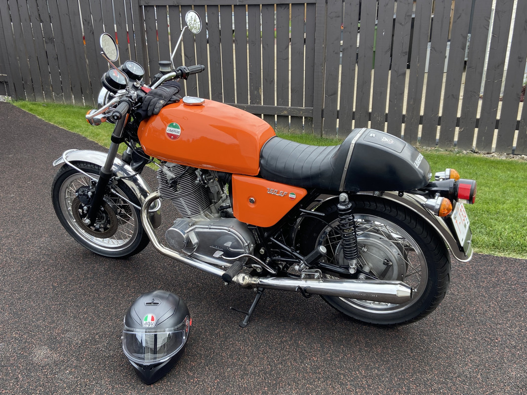

A pretty tired looking Laverda frame, I ran 220 grit dry paper over the rough original paint, acid washed the frame, neutralized it and brush painted POR-15, I did a LOT of masking but I did not disassembled the whole bike, motor stayed in the frame.
I removed what was practical and powder coated the center and side stands, fork lowers, foot rest brackets, swing arm and misc parts that were easy to remove.
I did this to see if POR-15 was practical to do as opposed to Powder coating, truth be told I only went this route on one restoration but it was satisfactory
painted frame
one the body work is back on, the eye doesn't pay much attention to a frame provided its not chipped and rusty, plus so little of the frame is visible
