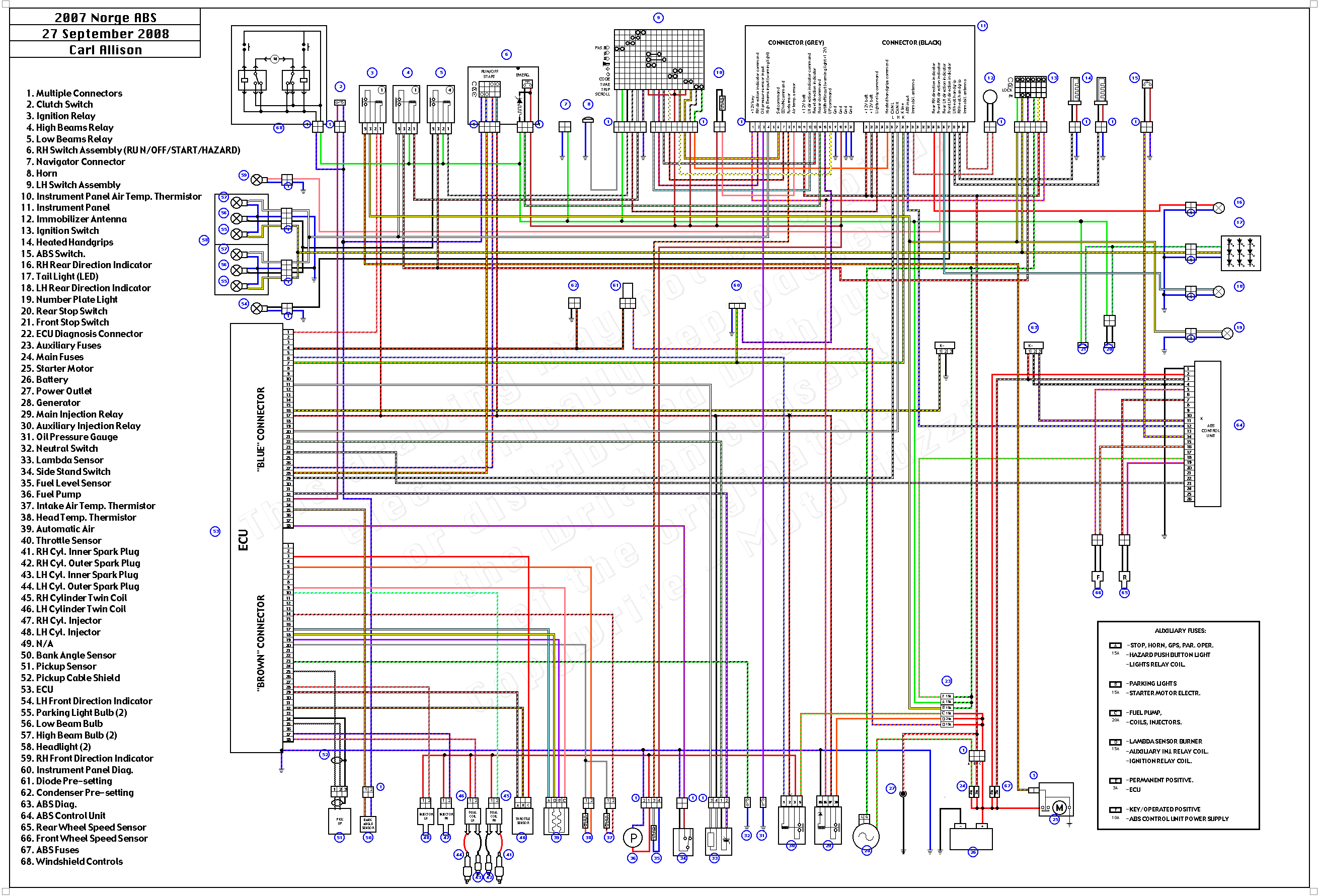

The bike has a relay (30) that closes when the motor is running
https://www.thisoldtractor.com/guzzi007/schematics/2007_Norge_ABS.gif
Yhe Auxillary Injection relay is only energized while the motor is running
Note the bikes headlight is not switched by that relay but relay 3 & 4, you can change that if you wish however it may not be a good idea for the headlight to go out if the engine stops.
You could also just wire the lamps directly from the Auxiliary injection relay.
Some Guzzi's have a city light or park light that comes on as long as the key is ON, I often use that light to wire the driving lights from.For sure if you don't have the lights on the Auxiliary relay or ignition switch you will have to deal with a flat battery before too long.

As I was saying the spotlights are typically 10 Watts
hook them onto the parking lights (55) in the headlight bucket and the tail Light., very easy to find those wires and no significant change to any loom.
You shouldn't need a relay the spots only need about 9 Volts and the ignition switch contacts good for plenty of current.
