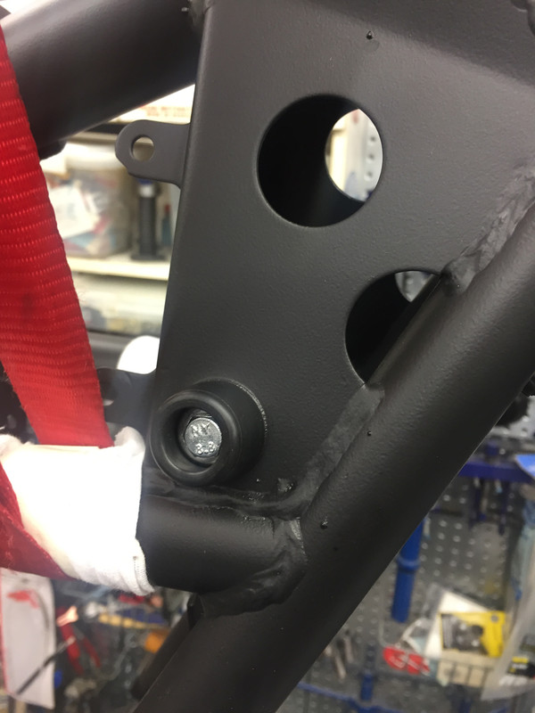

The powder coater I use specializes in automotive and motorcycle work, he also does commercial work but understands the expectaions of customers completing a restoration. The shop I use does all their own blasting, preheating, cleaning etc, and they take care of blanking off all holes, bearing surface etc. Doing your own prep requires a lot of work to get the base material properly cleaned and prepped, I use my vapour blaster and acetone wash for the small parts I powder coat in my shop with an old wall oven, I also use metal prep wash to treat the fresh blasted surface before any surface rust starts. I would make sure the coater shop you plan on using is familiar with motorcycle restorations, that they do their own blasting, metal prep and they bake out any residue grease and oil in the oven before coating.
Sand blast is too aggressive for this kind of work, at most I would use a fine glass bead or a soda blast.
this is a picture of the matte black powder i used on my 77 Le Mans restoration
