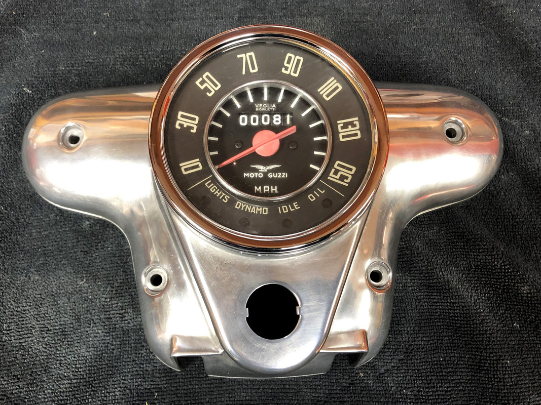

The speedometer for this bike is super nice!  The reason it has only 81 miles will forever remain a mystery.  It was obvious the speedometer drive was slipping for a very long time, but that doesn't explain the whole mystery.   I have essentially zero timed this bike so 81 miles is appropriate now.

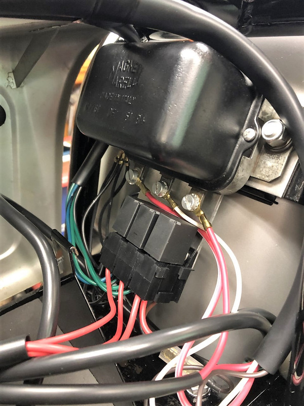

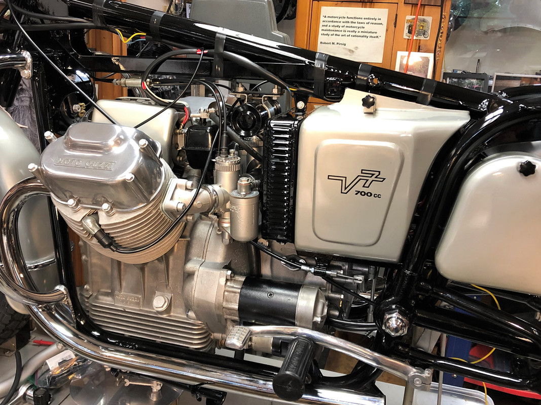

I am well into the wiring.  Greg Bender's wiring harnesses are things of beauty.  I always marvel at what he has done for the Guzzi community.
As I admire the details of this bike I ponder how inspired the overall design for the V700 was back in the day.  The attention to detail exhibited by the Guzzi design engineers is amazing.  And to think all of this was accomplished while Guzzi was teetering on bankruptcy.
All the tinware on this bike has all the telltale trademarks of much hand work.  You can see all of the craftsmanship.  The V700 was well executed at all levels including the artisan shop workers.
  • Posts: 4435
Re: 1968 V700 Rejuvination
« Reply #92 on: May 26, 2020, 12:32:36 PM »
I am deviating from stock to add one of Greg Benders "relay solution" panels.  It is a slick product that will protect the electrical system.  If rewiring a Loop I highly recommend it.

Great minds think alike. I put this together for my V7 a few years back. I used fused relays. Flasher can on the right.

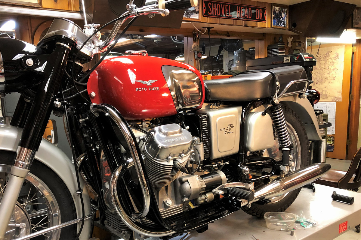

I got slightly ahead of myself, but couldn't resist mounting the tank and seat to see how it looks.

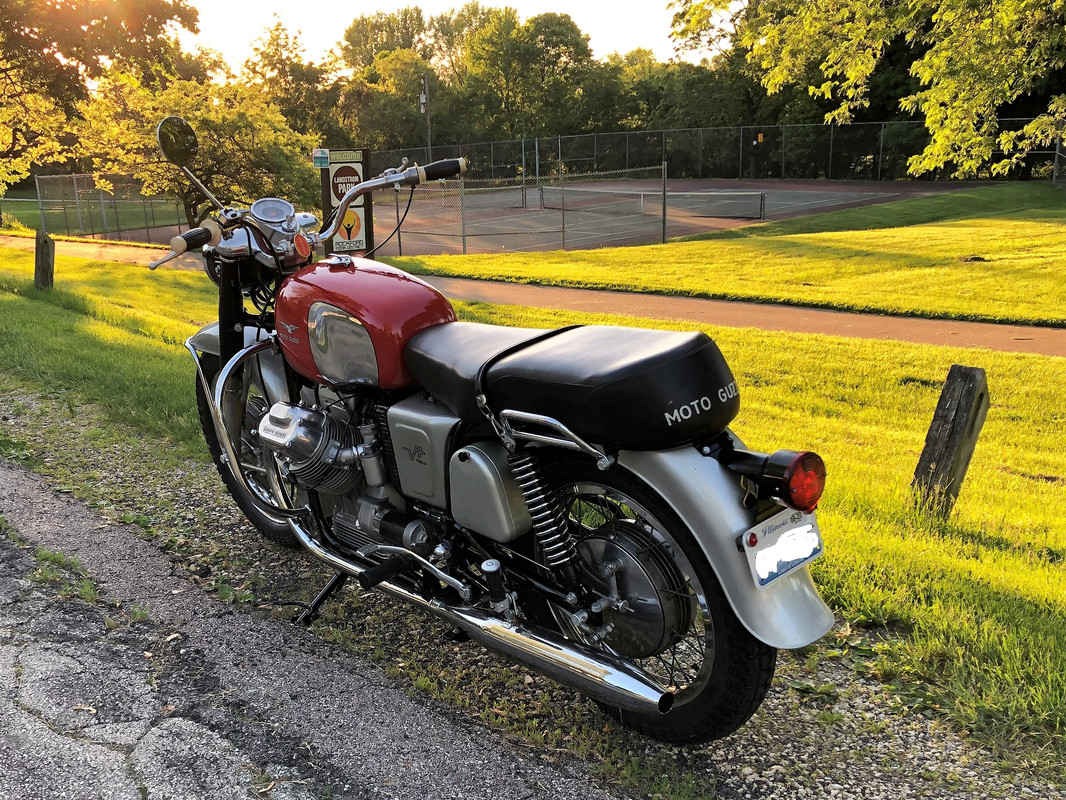

« Reply #101 on: May 30, 2020, 09:18:03 PM »

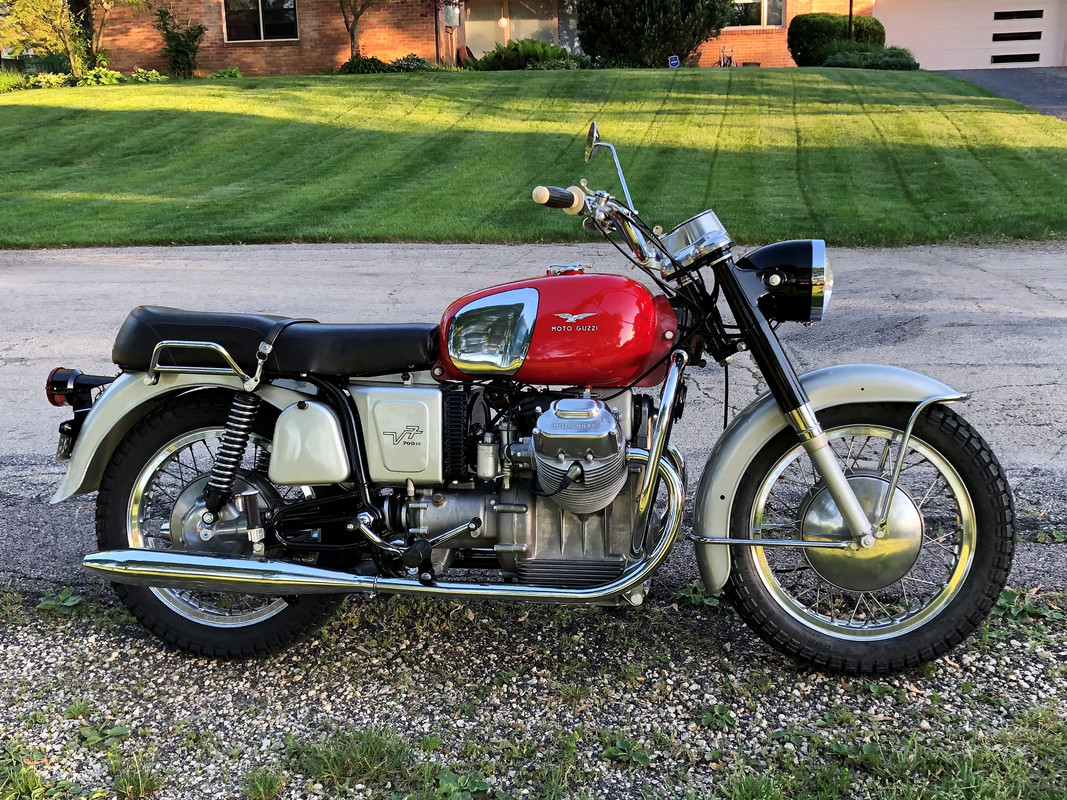

Productive day!  I finished the wiring.   The got the fuel bottle out and started it up in the backyard.  It started right up and idled pretty good.  I set the timing with a strobe light, adjusted the balance on the carbs and took it for a ride.  It runs beautifully!   The 4 speed shifts very well for what it is.  The straight cut first gear whines like a reverse gear in an old Chevy.  Pretty cool.
I put about 15 miles on it.  Tomorrow I will re-torque the heads.

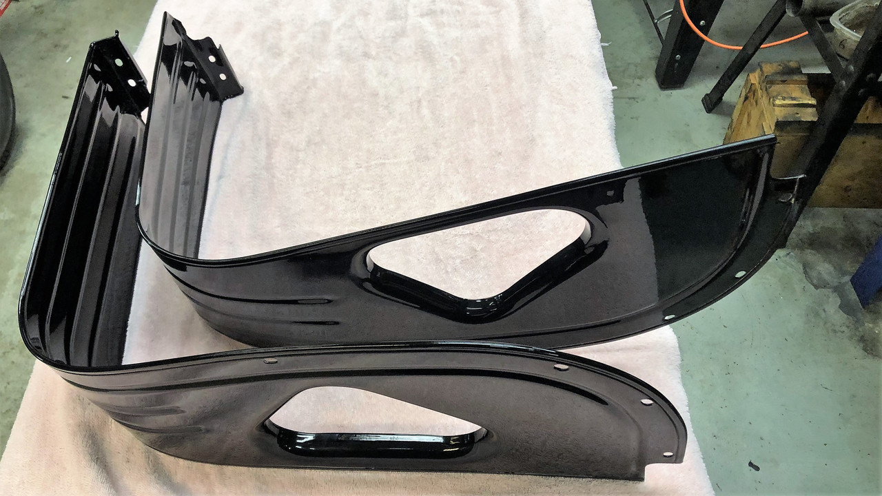

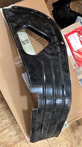

The last piece of the V700 is in place.  There are 3 major pieces, the shields, special crash bars with tapped holes, and special footpeg brackets.
Once I put the word out I was amazed how quickly these 3 rare items came together.  Eldo Mike,  Jay jas67, and Cam3512 all contributed.
The last piece from Jay was in amazing condition, but had had some sheet-metal modifications in the past.
The painter I go to is also quite talented with sheet-metal repairs.  They turned out fantastic!

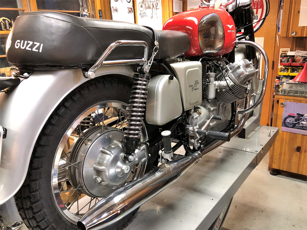

I finally had the opportunity to install the leg shields today.  Thanks a million to Cam3512. EldoMike, and of course Jas67 for helping make this happen.
