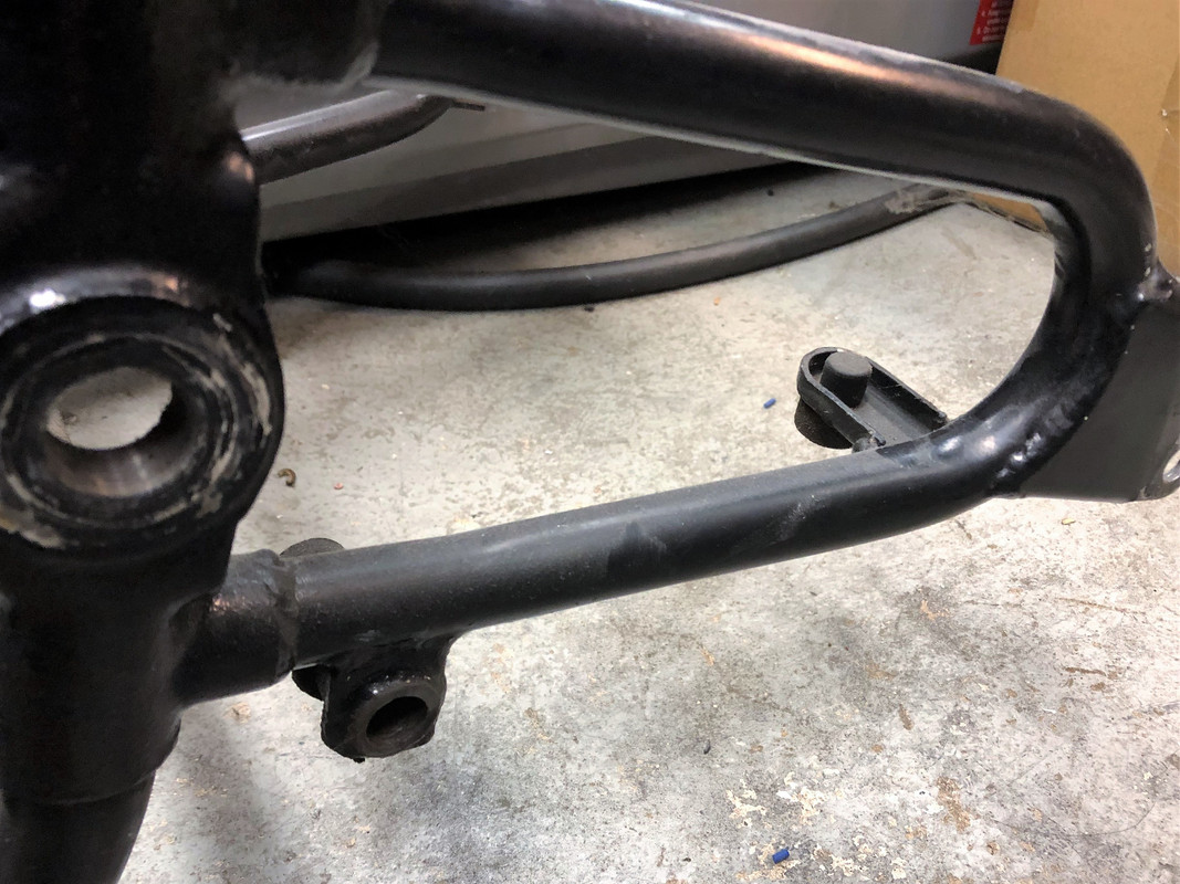

The original Record bikes were operated with no side or center stand.  When parked, some pics show the later curved Ambo-Eldo center stand in place, which does look more graceful than the V700 centerstand.  Can you look and tell me if the bumper or stand stop on frame for both the V700 center stand and later Ambo-Eldo stand is similar, identical, very different, same place, ??
When I cut the passenger peg frame loops to modify the frame for the rear sets, the OEM center stand bumper location will be lost.  I need to start planning how to resolve that.  I have to make and install the rearsets before I can do any significant work to make the exhaust.
If I just leave the sidestand in place as a workaround, that will interfere with an original-style full fairing that I plan to produce in the future....
Maybe you or someone else can help me with this information?

I checked both frames and the center stand bumper is located in the same place for both.
This is the V700
Online cliffrod
  • Posts: 2345
Re: 1967 V700 Corsa-Record
« Reply #13 on: September 01, 2019, 05:49:36 PM »
This is the V700
Thanks, Dave.  I thought they were the same and wanted confirmation.  I'll keep figuring it out.

The tank posed different challenges.  The tunnel is a more determinant and complicated shape to produce.  Too many bike projects I've studied have tunnels that are only an afterthought not well conceived imho.  the pretty outside is produced and whatever will fit is hidden underneath.  Not cool.  If you've had a variety of cool Italian tanks, you understand that some thought went into the various cut-outs and clearance bulges that differentiate certain tanks.  So I began with the tunnel considerations to incorporate the tunnel shape into the buck.
the original Record bikes apparently used a simple bungee cord, at least on the rear, to hold the tank in place.  I'll probably not do that.  I do need to clear the distributor cap, ignition coil and generator (planned to be changed to alternator).  As mentioned, I've always favored the black urethane tank mounting bushing like used on my V7 Sport over the typical foam & electrical tape or water pipe insulation....
Problem was that the V7 Sport bushings won't begin to fit around the larger top frame tube of a Loop frame.   I searched at length for a suitable off-the-shelf item, like a sway bar bushing, but found nothing of adequate size.  So I started making them.   As an experiment, I sacrificed my only hockey puck.  I made a fixture to hold it, offset cut/sawed the center with a hole saw in the drill press, used the belt sander to shape it and a 1/4" wheel on a bench grinder to cut the slot around the circumference.  It was too hard (around 90 durometer) and too small in both diameter and thickness, but it looked like I could do it.  I sourced enough black urethane spring die stock from a local craigslist seller and made what I needed.
I also made two 1/2" thick bumpers to match the tank bushings.  I'll mount these to help keep the tank vertical-
Image showing hockey puck experimental bushing (top) usable finished urethane bushing (left) blank for second urethane bushing (center) and spring die stock (right)-
Bushings on the frame-
Along with bike details like the distributor and coil, these tank bushings helped develop the pattern for the tunnel as the buck was produced.   I started by standing a spare moped crate over the bike to use as a basic measuring reference.  Since the clay tank model was only a half of the tank with a flat plywood backside, it was relatively simple to trace a pattern of the uppermost profile of the tank clay.  Then the clay was removed, the top tube was traced onto the pattern with a 1/2" allowance for the newly-made tank mounting bushings.  Now I had the basic backbone armature pattern for my tank buck.
