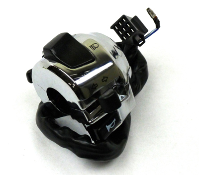

I'm using a RR45 Reg/Rec and new switchgear (K&S 12-0041) - and have opted to fuse the power to the M-unit (primarily incase of a reg/rec meltdown - the m-unit doesn't really need it apparently as should be able to handle just about any fault but nice to be on the safe side) - build will likely be a bit slow.

Can you provide more info about the switchgear?  From whom did you buy it?

Switch-gear is K&S 12-0041 - http://www.kandstech.com/pimages/12-0041.html  -- greg bender has a bit on thisoldtractor.com on them http://www.thisoldtractor.com/for_sale_wiring_harness_loop_KS12-0041.html
You can get them from MG cycle, Dime City and many other online retailers in the states. I got mine from WeMoto.com.au - they are just down the road from me and were the best price.
You can program the headlight & taillight to come on with the ignition. My build wont have an Ignition light so it will be a good way to ensure I don't leave anything on.
One thing I had to get my head around is that you actually "reverse wire" the switch, the inputs become the grounds (as they are often sharing functions between them (i.e. indicator power input), and the ground/outputs are your signal in.
If you wanted to you can wire it up with switch that turns the headlight from off-park-on (like the standard switch-gear), just need to add a relay.
