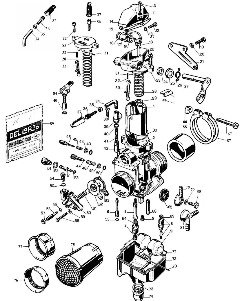

https://www.dellorto.co.uk/wp-content/uploads/2020/08/PHF-diag-image-map.jpg
What part are you looking for?
It doesn't show on that parts diagram either. It should be above #3, which I believe is the needle jet. #3 seats into that part which protrudes into the venturi. It's the only brass part you'll see when looking into the carb throat.
The part you are looking for is part of the housing. It is as you say at shroud around the needle jet. This is not a part you can get as a spare part.
