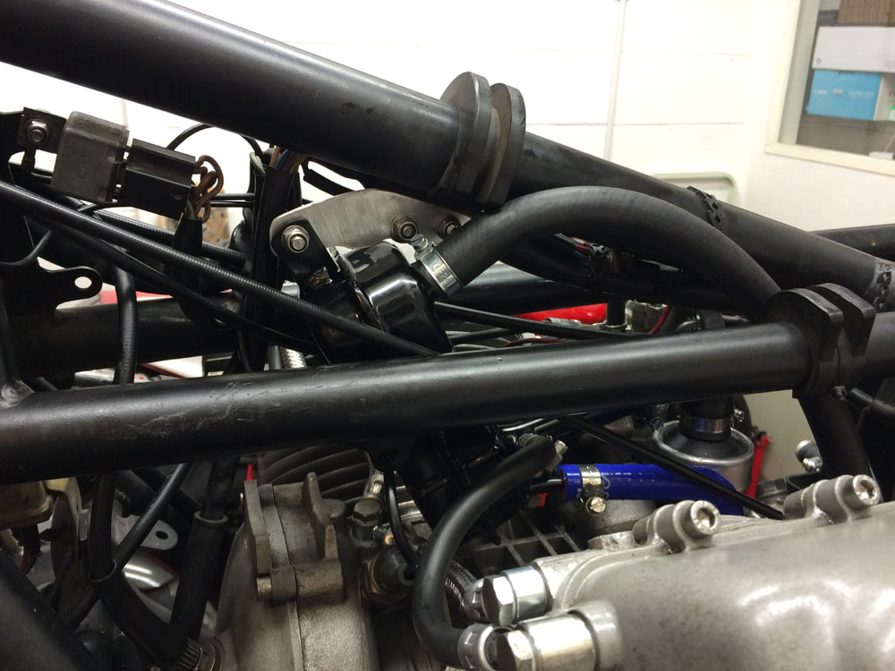

I have a bit of an obsession with crankcase breathers, mainly because my 900 Monster has a penchant for blow-by so I have fitted larger breather boxes to all of my bikes.
On the LM2, I replaced the OEM Lemans breather with a larger Agostini part but fitted a (customised) Ducati corse style reed valve in line as it is a much larger bore than the Guzzi part. Seems to work fine as I've had no evidence of any oil getting blown out though it maybe overkill?

« Reply #9 on: June 30, 2023, 10:53:24 PM »
Thats a very interesting setup Dukedesmo. It looks very clean. Do you also have a sump spacer?

« Reply #10 on: July 02, 2023, 04:54:46 AM »
Quote from: bigbikerrick on July 01, 2023, 04:53:24 AM
Rick.
___________________ ___________________
I have a G&G, external filter deep sump and a windage plate, presumably both help with oil control.
