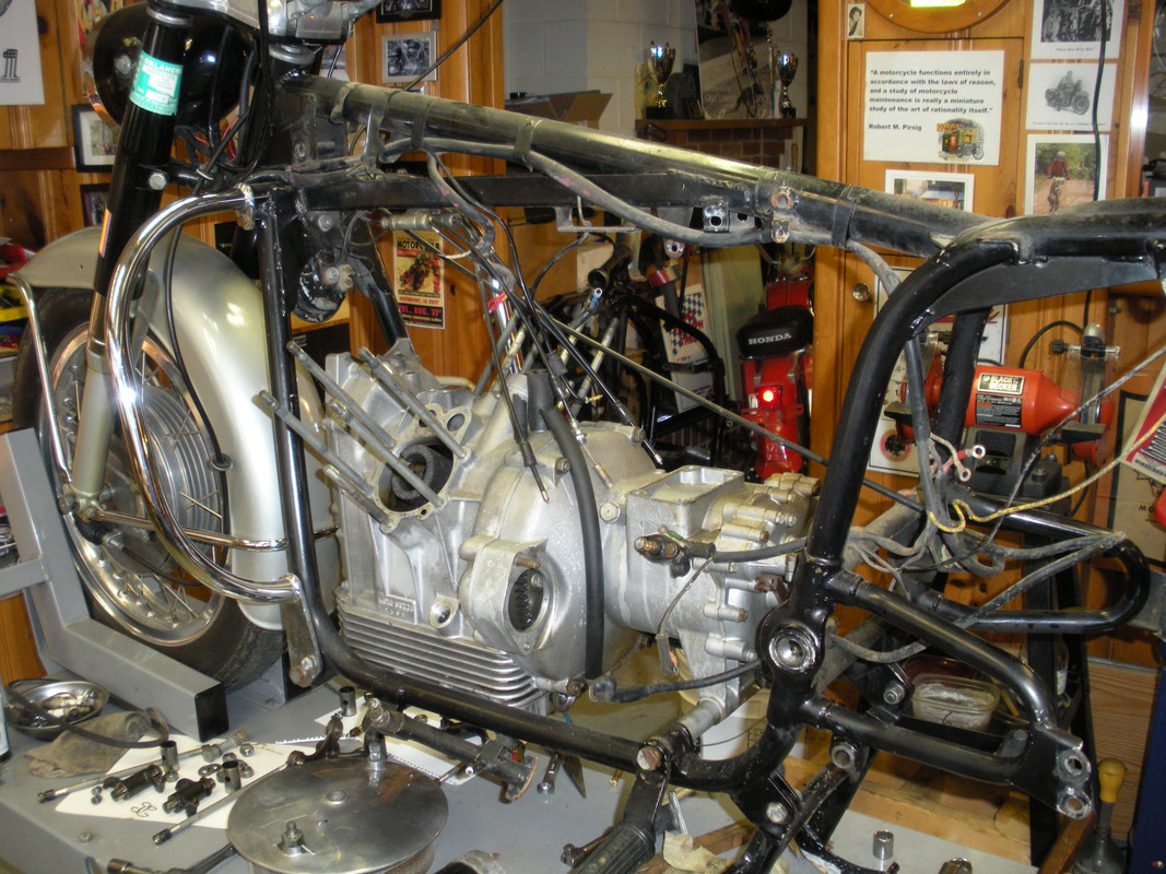

Shortly after the bike arrived I began the teardown.

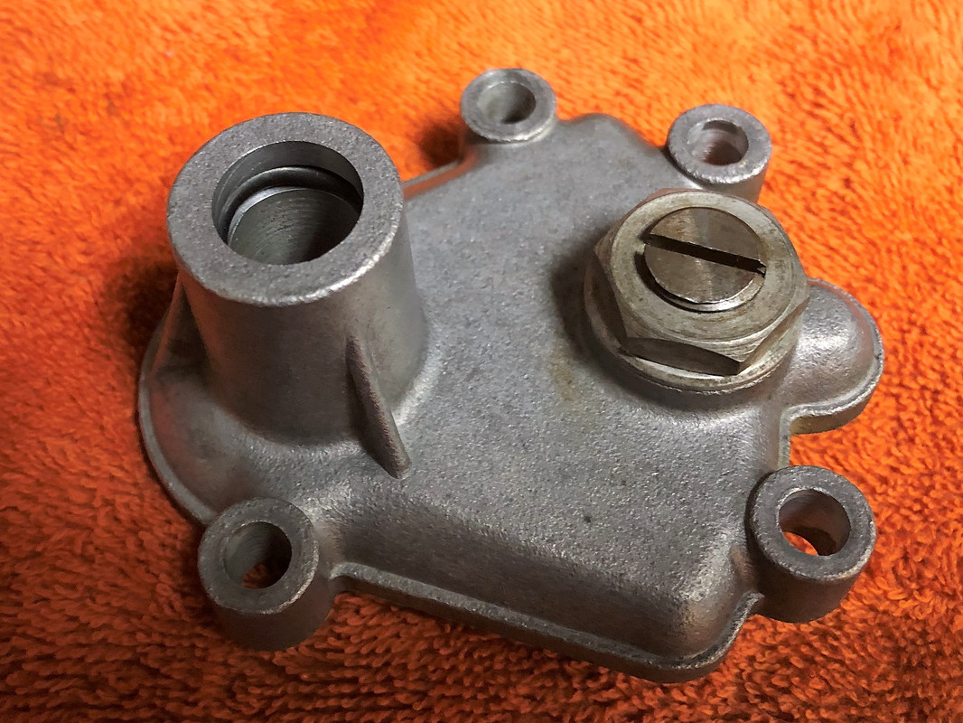

The V700 has many eye-catching features.  The tank, fenders, side panels, "pie crust" final drive,  speedometer and housing just look so good!  My all time favorite feature of the V700 is the oft maligned Dellorto SS1 29D carburetors.  I understand why many have replaced with later carbs, but to me a V700 doesn't look right without the original carburetors.
The SS1s on this bike had a few issues.  There was old crystallized gasoline in them which made disassembly difficult.  Thankfully there were only a few parts that needed to be replaced.  One of the pilot jets was seized and required a careful and nerve filled drilling operation to remove, but I was successful in the end!
Here are the carbs ready to be reassembled.
And here is what $250 worth of SS1 spare parts look like.  I am not complaining about the price.  I am beyond happy that someone still has NOS bits for these carbs or I would also be running a newer carb.

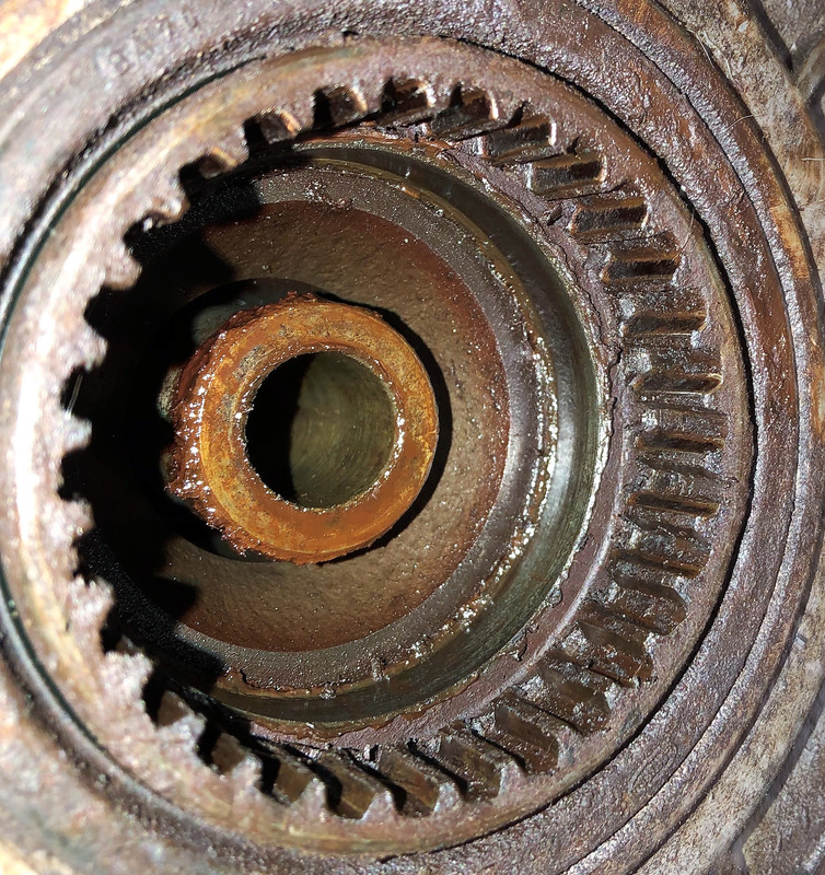

The more things I inspect on this bike the more I find conflicting wear indications.
Today I looked closely at the rear drive internal and external splines.  They are quite worn out, especially the rear wheel spline!  Too worn out to put back together that's for sure.  I am looking for splines now.
I am beginning to get the impression that this bike sat around the shop so long it was used for a parts mule from time to time.  No way of knowing for sure, but that would explain the difference in wear items.

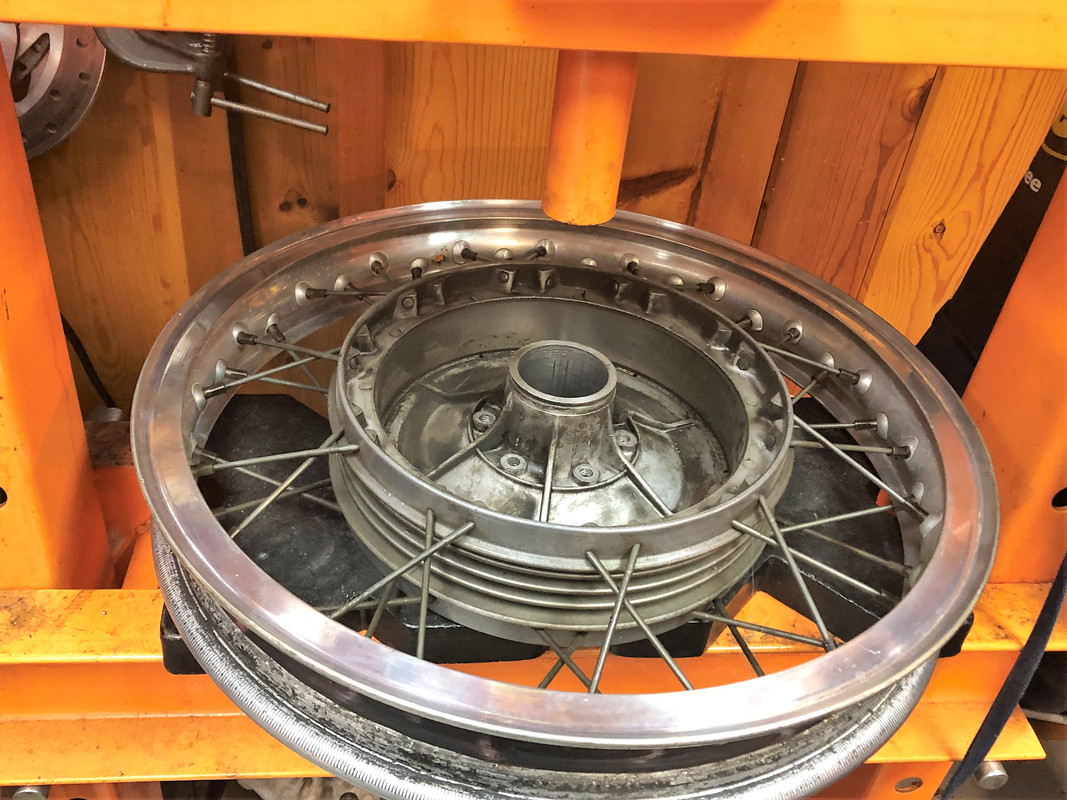

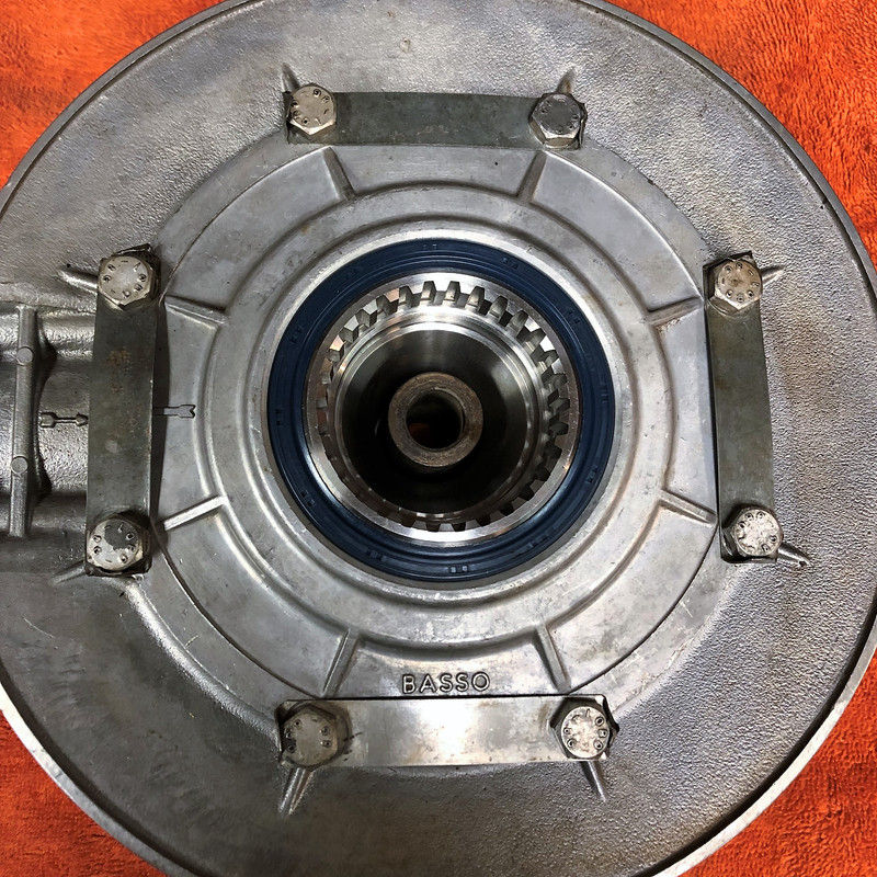

The wheel hub was quite the little project to remove.
The wheel hub OD is precision ground for a press fit, which I expected.   I was not expecting that the 6 bolts holding it in place would also have a press fit.  It took quite a few blows with the brass drift to remove each bolt.  During assembly, bolt hole alignment will be critical.
Using my trusty Jett lathe I fashioned a driver from a Craftsman 1 1/2" socket to push out the wheel hub.  The OD of the socket was a perfect size for a clearance fit of the wheel hub housing.
The driver will perform double duty when pressing in the outer races of the Timken bearings.
I warmed up the wheel hub aluminum housing with my torch.  Using my cheapo Harbor Freight press with one big pop the hub let loose and it pressed out without drama.

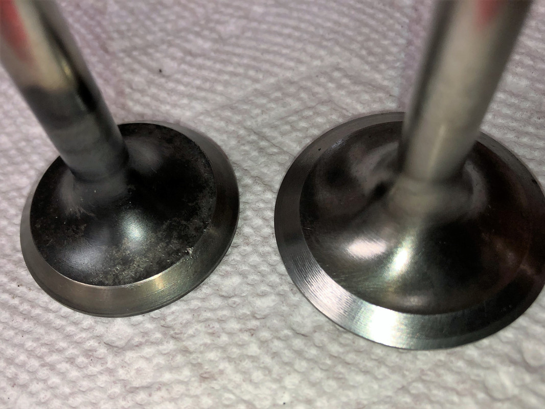

After some discussion with Charlie we have decided the condition of the valves, guides, and seats do not warrant a valve job at this time.
Charlie also reminded me earlier that V700 valves are no longer available.  They are not the same as used in Eldos and Ambos.  Just to be safe I snagged a couple sets.  It is always interesting to find parts still in their original wrap for the past 50 years.
If there are any smoking issues down the line these will come in handy!
The valve faces of the original valves are in great shape.
The seats are in very good condition also.
You gotta love the V700 valve covers.  None nicer than these on any of the models that followed in my opinion.

The wheels are done!  I always like have the wheels finished and set aside early during a restoration.
Since the rear wheel has a new splined hub and a new Timken bearings, shimming for preload needed to be performed.
Using one of the axles and spacers to take up the slack space allowing me to torque the axle nut, I just kept adding shims until it became too sloppy and then backed off until I hit the sweet spot.
McMaster Carr has a great selection of metric shims that fit perfectly.  I ordered what should be a lifetime supply.
Wrenches down, time for a celebratory beer!

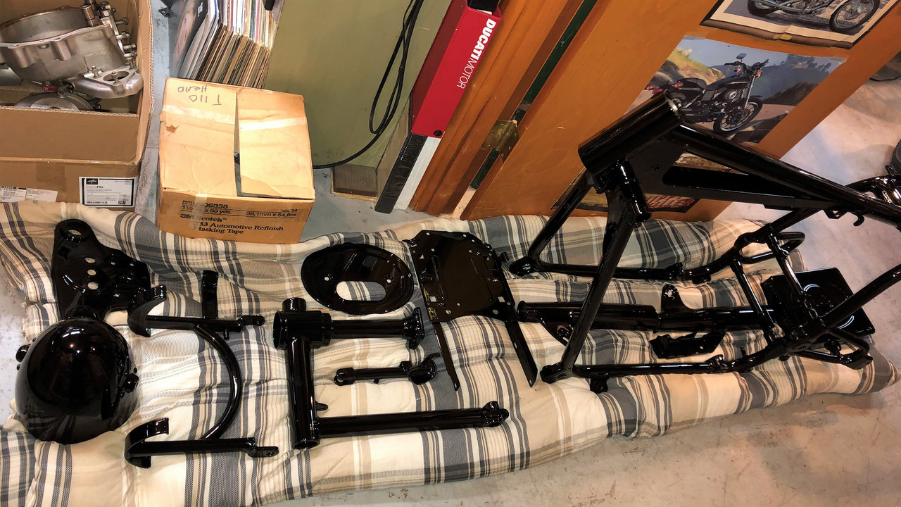

I also got all the black parts back from the painter today.
What did your painter use for paint? I've been a fan of powdercoating for frame and chassis bits, I know there are some tough paints, too.
Larry
'13 Monster 1100 EVO
'95 Cal 1100
'68 Bonneville
MGNOC 7248
  • Posts: 4447
Re: 1968 V700 Rejuvination
« Reply #28 on: November 24, 2019, 09:19:27 AM »
Larry
A single pack black as I recall.  Then he sprayed a coat of clear on it which I hadn't asked for and really preferred he had not.  I prefer the original look for frame paint.  The painter did such a high quality job I didn't have the heart to tell him I didn't want it that glossy.
Personally I do not care for powdercoat.  As far as being tough, I have bikes that are 60 and 70 years old with the original frame paint that is holding up well.
