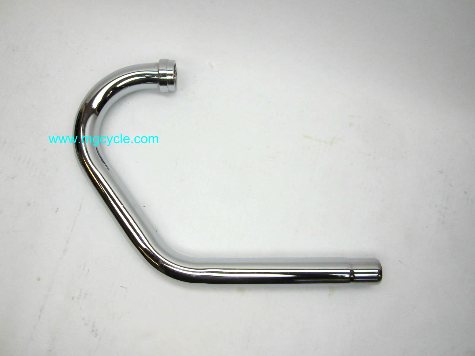

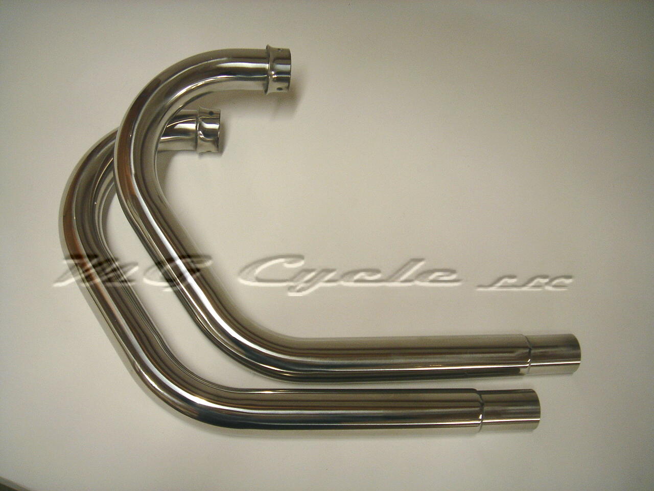

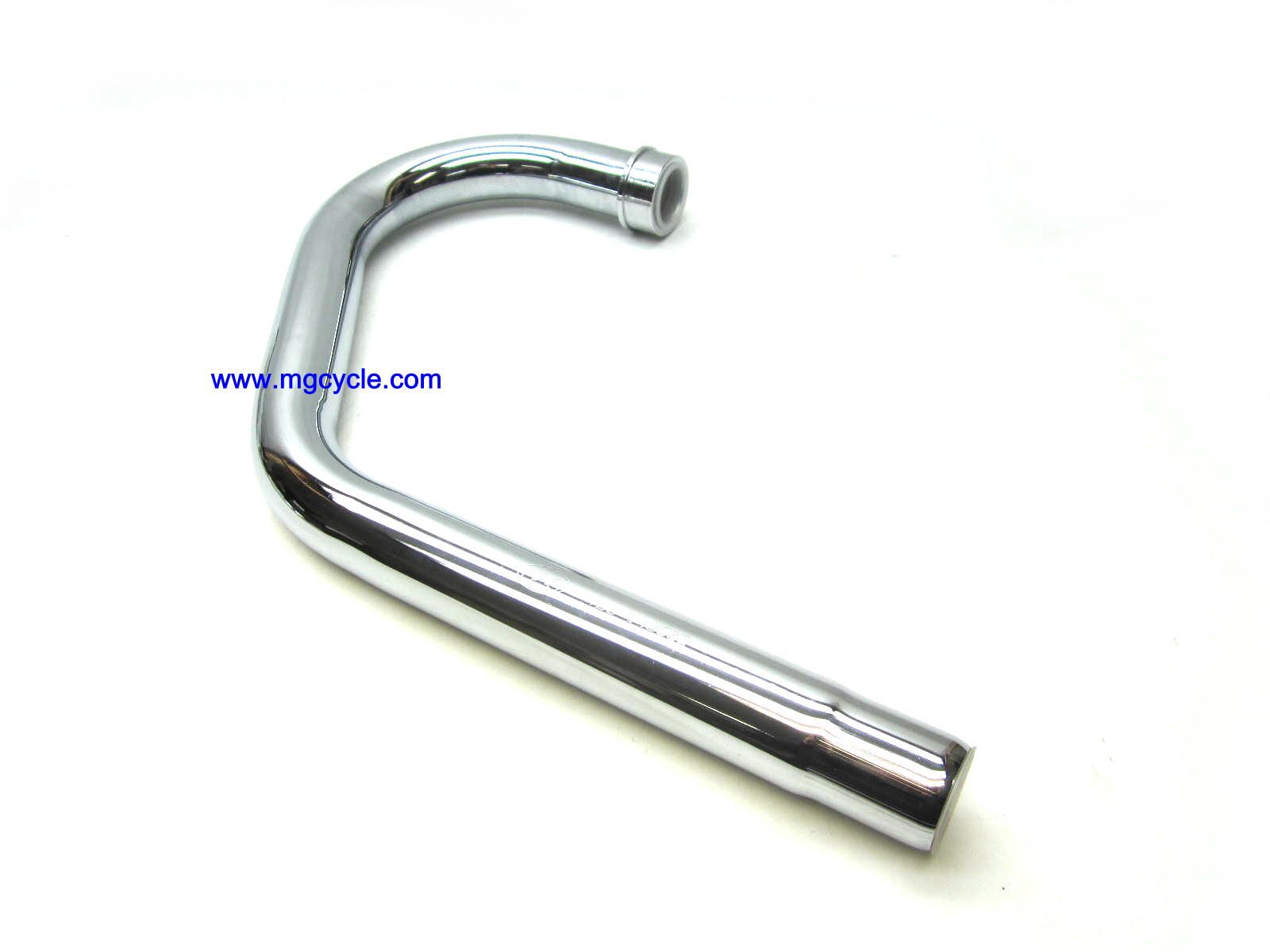

My Titanium has cracked the weld on the left side front crossover.  Rather than have it welded just to have it crack again, I'm thinking of replacing the head pipes.
MG Cycle has double walled chromed head pipes or Mistral single walled polished stainless head pipe.
Double walled chrome: Right
Left
Single walled stainless: http://www.mgcycle.com/index.php?main_page=product_info&cPath=26_108&products_id=2578
Has anyone here used either of these?  Will the chrome head pipes rust?  I'd rather have blued stainless than rusty chrome.

I like single wall stainless. I don't find heat a issue, and stainless pipe discoloring is art to me. What I don't like about those SS pipes shown is the flange. It looks swedged, and basically like flared sheet metal, and I wonder about its longevity...
