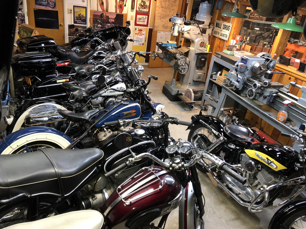

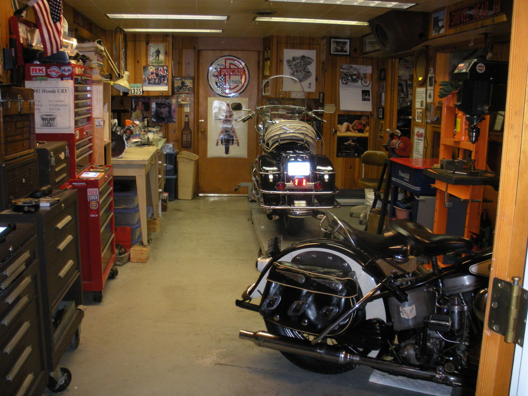

I just wanted to comment on such a wonderful looking shop you have Dave
I am forever indebted to the original owner who had this house built in 1959.  He was an engineer and made having shop space a priority.

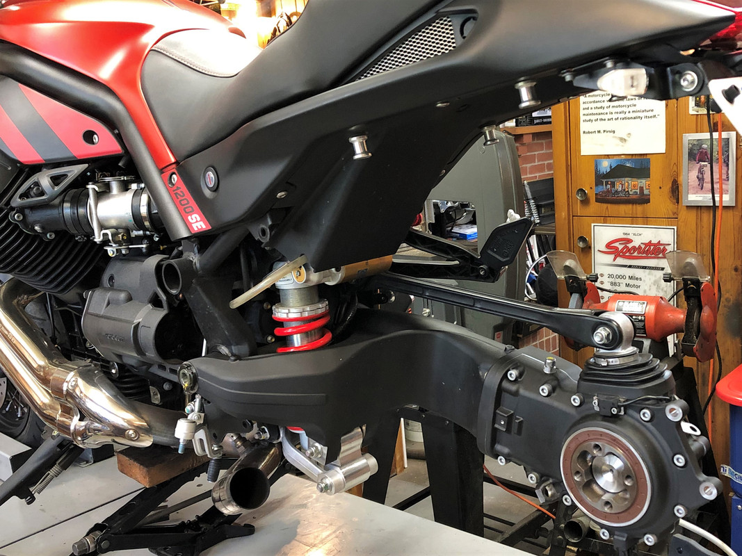

A couple of things.
Support the weight of the bike on something other than the centrestand. The removal of the required bolts will allow the bike to settle hazardously under it’s own weight. A chain block from above is ideal.
There is not a positive mechanism to reliably prevent the right side swingarm pivot pin seal to become dislodged during reassembly. I made a spacer to go between the seal and the housing face, with a modicum of clearance..(about 10 thou’).
When I first disassembled mine at 90,000 k, after witnessing the dry rollers falling out on the floor and the rusted cage collapsing in pieces, I had the pleasure of seeing the crunched seal laying in the bottom of the housing that had NEVER been in place...!
Don’t omit to grease the drive shaft splines before assembly.
Oh and..
Whip the CARC off and check the security of the pinion retaining nut...
Proofread.  Grammar.   :grin:

I like your shop.  You have some nice shop toys.   :thumb:

With learning curve intact the Griso only took 2.5 hours start to finish.  It too had minimal grease with the forked arm being bone dry.

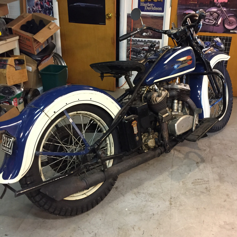

  • Posts: 4288
Re: Norge Prep for the WG Rally
« Reply #49 on: April 27, 2021, 11:25:03 AM »
Your bikes are all so clean, no dirt, grease, etc. Does anyone actually ride any of them?
They are all well cared for.  And they are ridden.
2022 V85TT Guardia d'Onore
  • Posts: 4288
« Reply #50 on: April 27, 2021, 11:26:30 AM »
Dave,
What is the Harley with the blue tank next to the BMW?
1936 VLH
