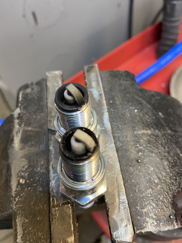

over rich is often called 8 stroking. it has a rhythm ,like dah, dah, dah ...lIn reality every plug check should have new or cleaned plugs..I find it takes up to 5 miles to get a plug color..
 Many here might call this lean but it's just a touch rich.Notice the carbon on the end of the screw shell...About 10 miles ion the backroads running between 60 and 80 mph on my 750 Triumph using 90 octane non ethanol pump gas. E10 might need to show a bit of color..

My plugs are much, much darker than yours, I used three pairs of new NGK plugs for each cop, ran for about ten minutes before killing the motor. Called another bike shop and they have the smaller jets I need, back to plug chops tomorrow.

These pictures are of the two plugs running on the 125 main jets, the last 15 minutes was riding through town with stop and go traffic
The bottom plug is the front cylinder, the top plug the rear.
Sooty outside of the center, I should probably try another clean plug chop for WOT and take another look at the plugs
I need to check the idle / pilot mixture scews and resync the carbs, the bike felt a bit rough at speed.
