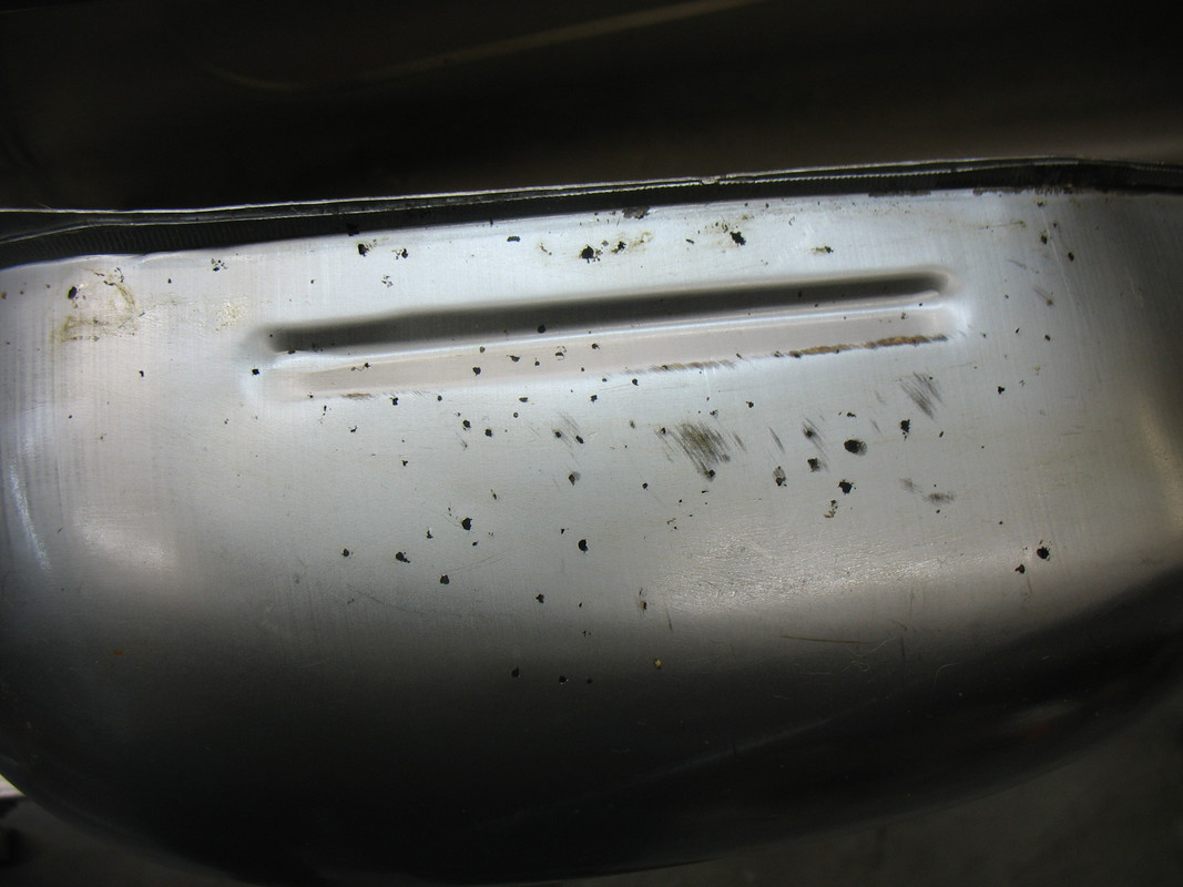

  • Posts: 2143
Re: Pinhole Leaks
« Reply #24 on: May 11, 2021, 09:40:41 PM »
I dug this old picture up of my 1972 Eldorado gas tank that started to leak from a pin hole after I had it repainted. One pin hole turned into two, then I sent it off to be dipped at the local paint and rust stripper shop (big dip tank takes a whole car).
This is what came out! I could take an awl to the bottm and push it straight through in many places. I cut out the tank bottom, formed new steel bases and welded the panels in, .... then it started leaking from the top of the tunnel.
I found a better tank and exercised a 10lb sledge hammer on the rust bucket original tank so it would fit flat in my garbage can! I don't even try to weld up rusted tanks anymore. I still have not learned the same should apply to rusted out fenders!
My 68 Sears Gilera 106SS gas tank looked even worse after paint / rust stripping. The tank doesn't look too bad in this picture, look closely at the underside, those orange rust stains were coming through an endless array of pin holes only slightly blocked by thick rust flakes and crud on the inside. This tank made the Eldorado tank look 'good'.
I am not trying to be a buzzkill, just being realistic as to what to expect from a 50+ year old gas tank that has been exposed to condensation.
Tank liners may buy time but if the rust remains under the tank sealer the corrosion will continue and work its way through the metal, rust is relentless, covering it up doesn't stop it.
