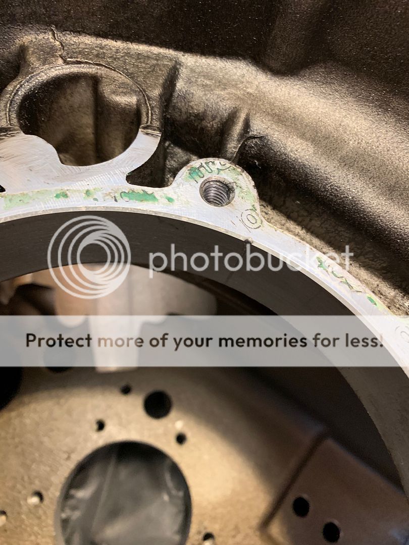

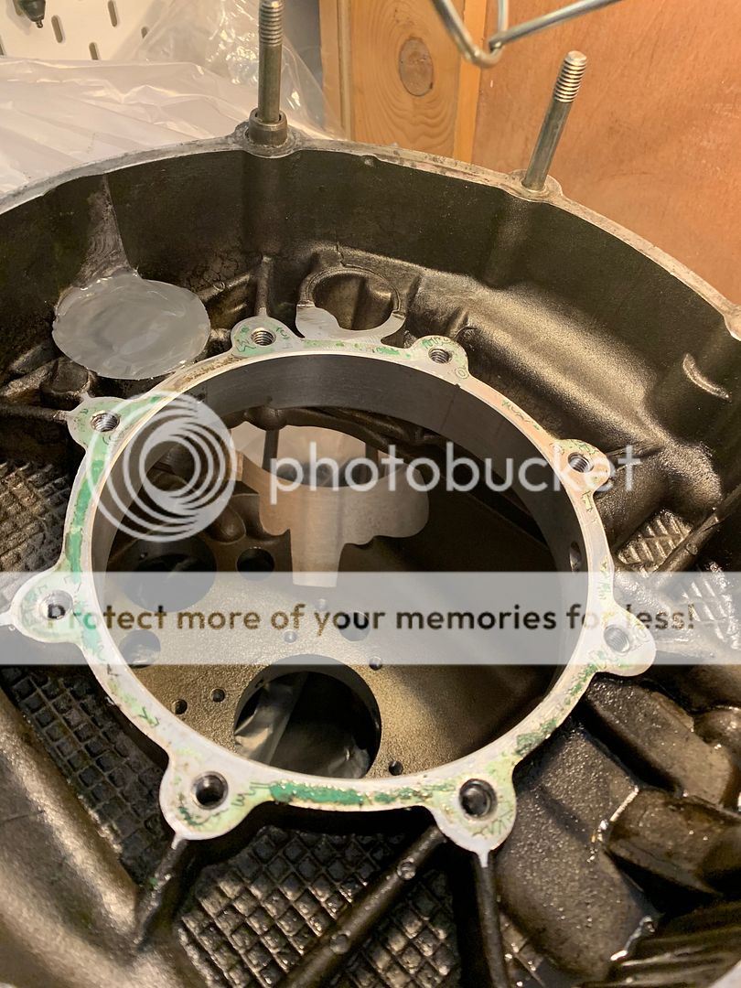

Calvin 1100 engine
rear main flange recently out
was flipp-------ing tight in there
factory tool couldnt move it, so pressed it out
made quite a -pop- when it let go
now there is a nasty nick/scratch on the crankcase (maybe it was always there?)
about to rebuild the engine, should I worry??
thanks to all as usual    :thumb:

No problem. The damaged has no function. You seal the rear crank bearing with a paper gasket.

 Yes , go ahead and worry.

Check for a burr on the main bearing that could have caused this, carefully remove if there is one. Carefully remove any burr on the case that may make it harder to insert the main bearing or that might interfere with gasket sealing.
It might help if you can warm the case and chill the bearing before assembly.

It looks like a burr or maybe a machining chip was on the bearing carrier. I'd file it off, measure both if you have the capability, and don't worry, be happy.  :smiley:
