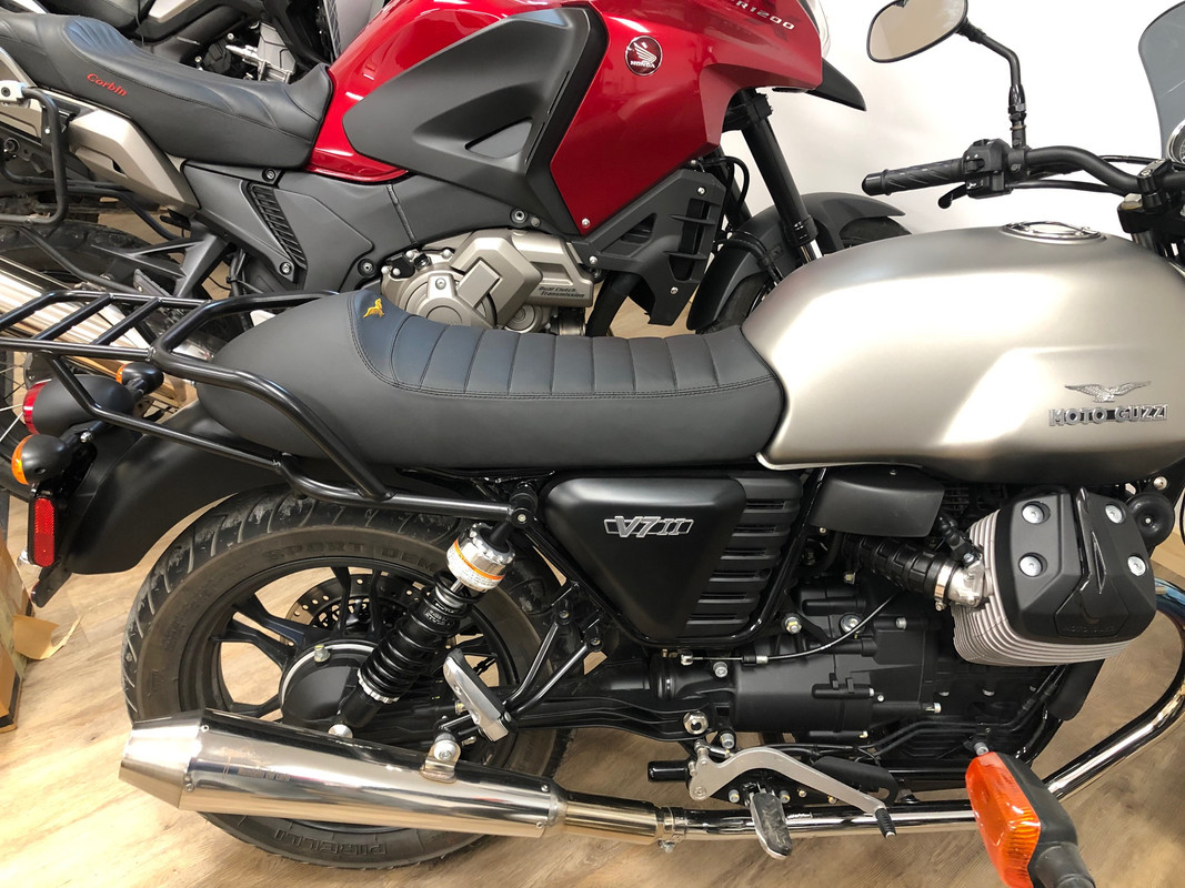

I purchased my 2016 Stone II from the local metric dealer last year, it had been traded in with 590 miles and had been sitting on their floor for a while. Anyway I was browsing there last week when the sales manager tells me "hey the guy that owned the Guzzi you have was just in and asked if I knew who bought it because he has a seat for it that he'll just give you". He calls the guy who comes there in 15 minutes with a new, 3/4 seat in the box saying I can have it because it was just taking space in his garage. I say I'll buy it but he says "no it's free", I end up giving him $40. Then he pulls some little device with wires from the box says "you can have this too, it's an ECM programer from Guzzi Tech that is married to the bikes VIN and has a map for the Agustini slip-ons w/o the quiet inserts but it's a little rich for it with them in so I put the stock map back on.
Not sure the seat looks good on a Stone with a luggage rack but I like how it sits, it's perfectly flat which allows me to slide up and back. I could do this on the stock seat too but it had a slight hump which I ended up sitting on when I slid back so this one's better for me.
