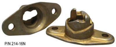

It's not that difficult as long as you have a tab to hold the clip portion or some flat area to pop rivet the clip.

I'm rather partial to Camlocs. No special tool needed for installation (for removal you'll need a retaining ring cutter). Available in cad-plated or stainless. Also with Phillips head that makes it less likely that a slipped screw driver scratches the paint.
Get them from Aircraft Spruce:
https://www.aircraftspruce.com/categories/aircraft_parts/ap/menus/ha/fast_1camloc.html

I've used Dzus. Camlocs +1 R3~
