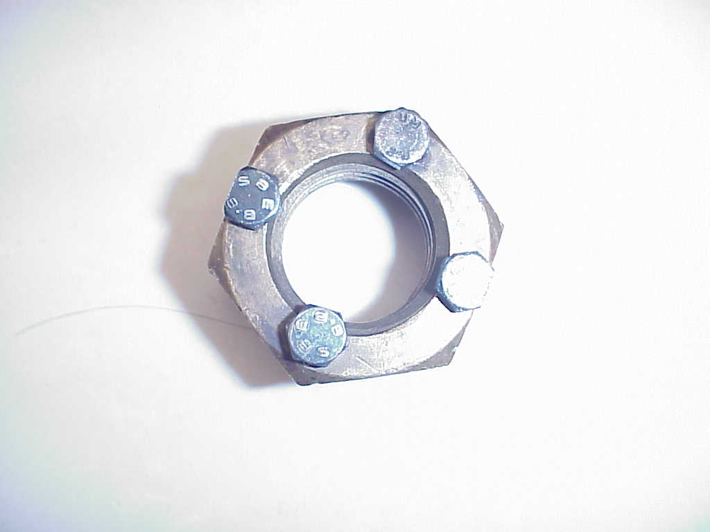

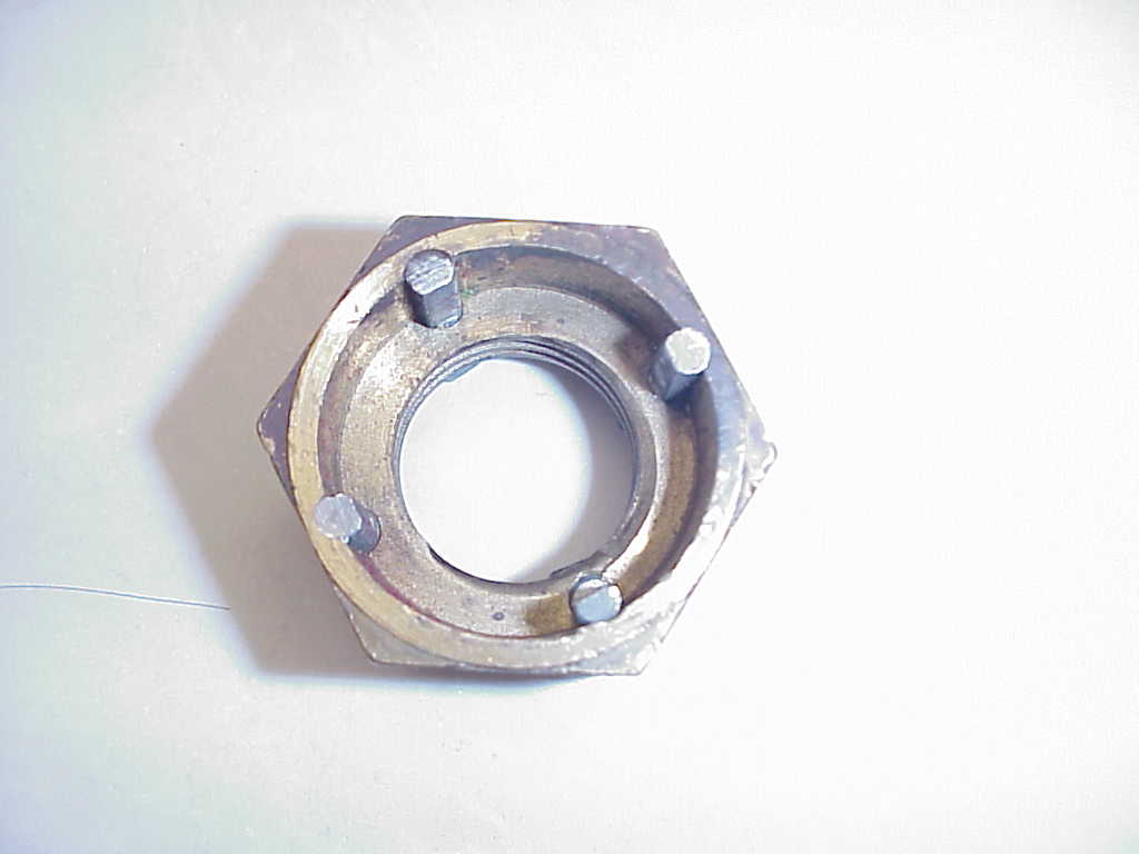

Most of the recommended tools are too big to carry in a roadside emergency kit.  I found a big, brass nut.  I bored out the center on my lathe.  I installed four small screws and rebored.  This fits nicely in my tool kit and can be driven by an adjustable wrench or channel lock pliers.
