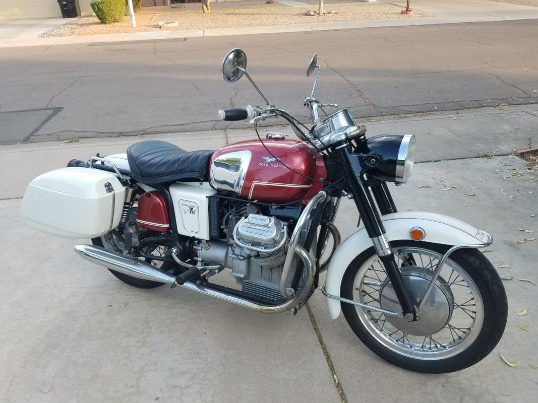

Even if it has Iron barrels , I think that's a bit pricey. Incorrect gas tank kills it for me. here is mine. A12243

Super easy re-fresh, not a restoration. The only thing I did to her was re-paint the tins, swap on the VHBs from my 850T, and install gilardoni's. At 32,000 miles, the chrome bores looked almost perfect. go figure, maybe being stored in the Arizona desert had something to do with that.
here's the before from 2012
