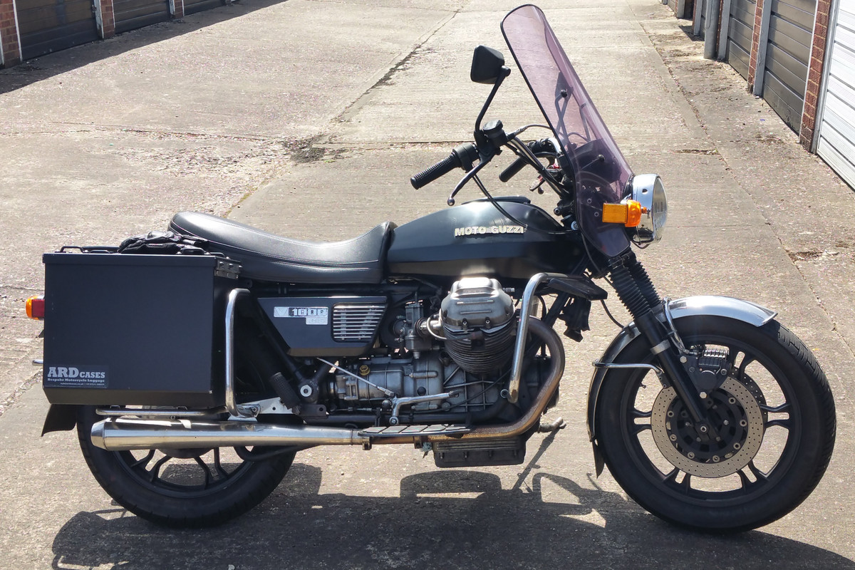

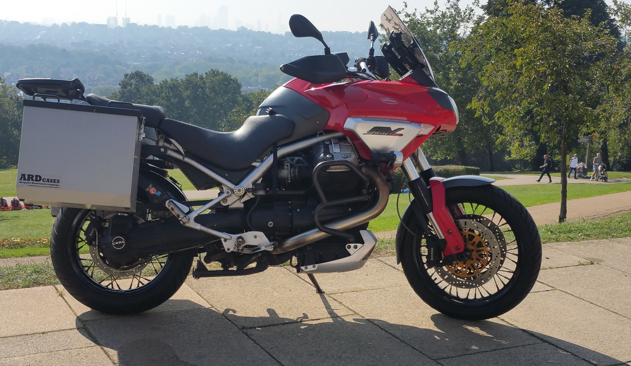

So when it came to building a frame to carry my Ardcases the main criteria  was that there was enough room for my pillion to move their feet around a little. If I were doing it again I'd have a non pillion setting bringing them forward a wee bit.
On my G5 I used the standard racks and slightly narrower Ardcases. They barely come out past the crashbars.
Cheers
