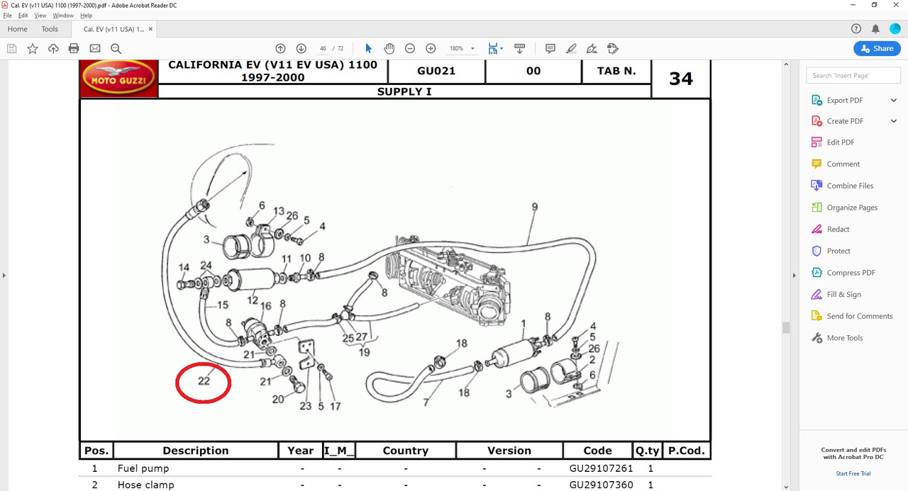

Started and ran better, until I noticed the fuel spewing up near the front of the tank. Turns out the high pressure line has cracked. This is the hose that runs from the regulator to the tank. The one with a banjo at the regulator, and a metal threaded hose fitting at the front of the tank.
Anyone know who might stock these? Or do I take it to a hydraulic shop and have them reuse the fittings?  Or can I just buy good hose and use quality hose clamps and do it myself?
That's not a pressure hose.  After the regulator, this just bleeds off excess flow back to the tank and cycles like a fish tank.  Still shouldn't be leaking.
Sounds like you are describing #22 from this sheet:
Not sure why it wouldn't load my clipped image:
MGCycle doesn't list it.
AF1 in Texas does.  Guzzi part GU30108770.
Harper's has the same part but need to search without the letters.

That's the one Patrick.  Sure leaks like there's a lot of pressure, but I suppose you are correct
May just try the hose clamps with new hose.
