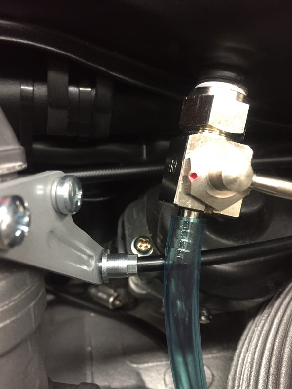

I had mine set up with two individual L/R petcocks, marked BAP to a single inlet banjo on each carb.   Mentioned the lean behavior when tank got low on fuel and Charlie suggested a dual inlet banjo and running a balance line.  Fixed it right up.  Ran all the way down to reserve then lower with nary a pop or hiccup.
She's running good.  Now if only those crazy stiff FAC dampers would break in....
Good on the lean fix. Yeah the FAC’s take awhile to break in, did you also go with Wirth springs? Took me about 3,000+ miles to break those in on my CX. I have the stock set up on this Lemans and so far I have no complaints.
