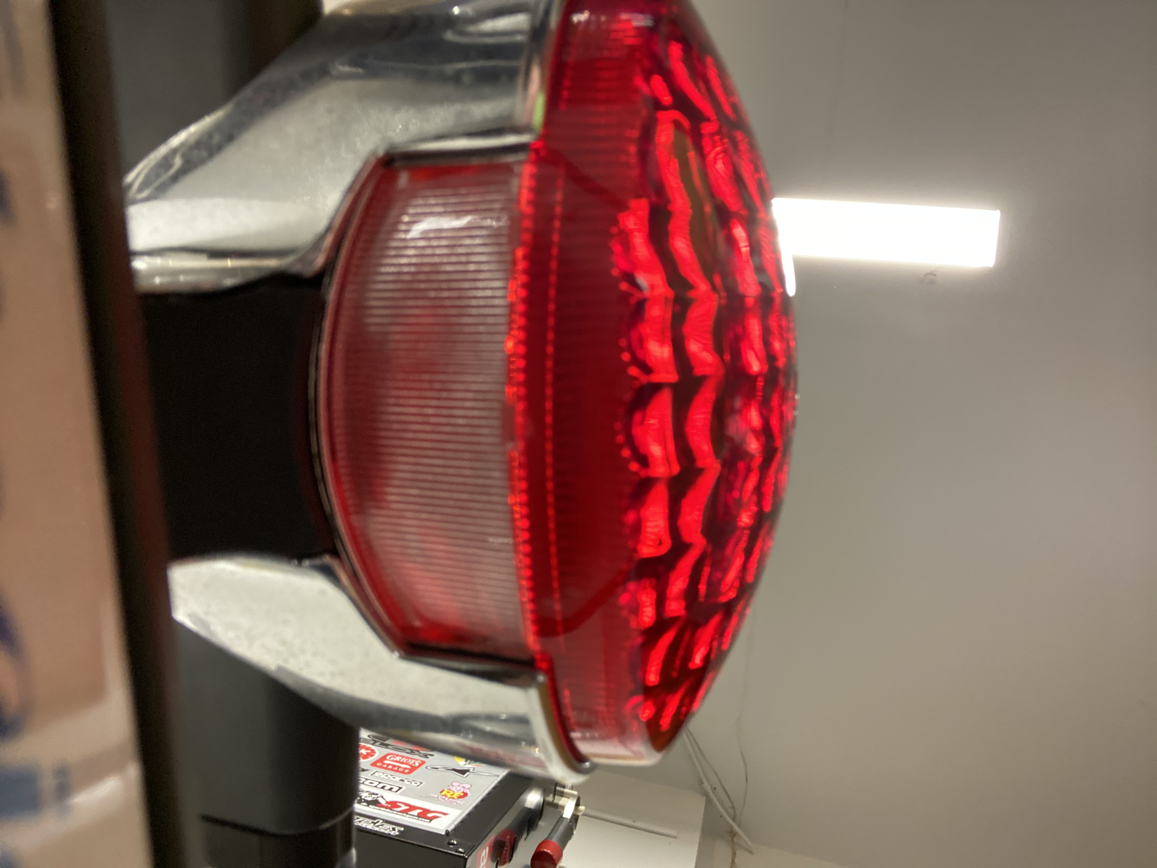

Offline John A
  • Posts: 5404
Re: License plate light
« Reply #1 on: August 11, 2020, 09:48:59 AM »
Can you post a picture of the taillight, especially the underside?

Offline greer
  • Posts: 733
  • Location: Glasgow, KY
« Reply #7 on: August 12, 2020, 05:56:16 AM »
Here you go:
Thanks for the ideas, everybody.  That clear lens insert is the slickest solution by far.  First off I'll do as Malik suggests and look around town to see what AutoZone and such have to offer.  I know some folks like to tidy up, but I don't mind the tail plate, so maybe I can find something cheap and simple right here at home.  Thanks again and I'll report back.
Sarah

Offline Bulldog9
  • Posts: 3523
« Reply #16 on: August 14, 2020, 08:29:47 PM »
I have a Stornello that has a black plate in the bottom of the tail light, and has that fugly bar light below the plate. I removed the barlight and replaced it with an AUX brake/tail light, and bought a new tail light housing from AF1 (I think) for $15 that has a clear plate to illuminate the plate from the tail light.

  • Posts: 15085
« Reply #18 on: August 15, 2020, 09:21:18 AM »
Thank you Bulldog, that's just the ticket.  Could I pick your brain a bit more regarding the source of that tail light lens?  I've searched AF1 every way I can think and haven't found a thing related to tail lights other than the expensive tail tidys.  I apologize if I have overlooked something obvious.  Thanks again.
Sarah
This one?
https://www.af1racing.com/store/Scripts/prodView.asp?idproduct=53538&sku=GU03740930&description=Tail+Lamp+Eur+%2D+GU03740930

Offline Bulldog9
  • Posts: 3523
« Reply #20 on: August 15, 2020, 10:33:29 AM »
Sarah
Sarah,
I went to the parts diagram on one of the models that has the clear plate and came up with this.  I just went through my orders and confirmed.  Price went up, $I  It is the whole taillight. I just swapped the lens.
I really like the ability to look at the OEM parts fiche, and search by part number. Much easier to find stock parts.
MGNOC#23231
