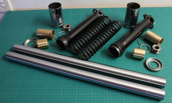

My original 1973 forks have new stanchions (the 'best ones) bronze bush kit, new seals with MG Cycle springs. (They go up and down)
I had looked at adding Showa cartridges to the early drum brake fork but never could find replacement lower sliders to modify (Add a central bolt fixture at the bottom by ship in a bottle machining)
