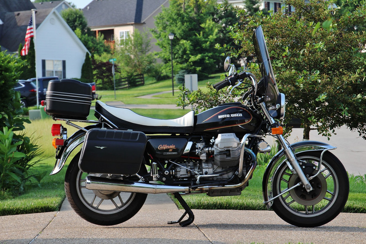

I think they are attractive motorcycles!  This one was for sale a couple of years ago.  I was tempted but must draw the line somewhere.

I had a 1983 model with the skunk seat....looked just like Dave's picture.  Really a great highway bike at the time....not so much in town because it is pretty long legged.  Eventually, I put it on consignment sales at Moto America in Lillington, NC which was also the home of the national importer.  It sold pretty quickly for a fair price.  I was back down there a month or two later and asked if the owner was happy.  Emily told me he was happy....until it was stolen off the streets in Philadelphia.  Always felt bad about that.
