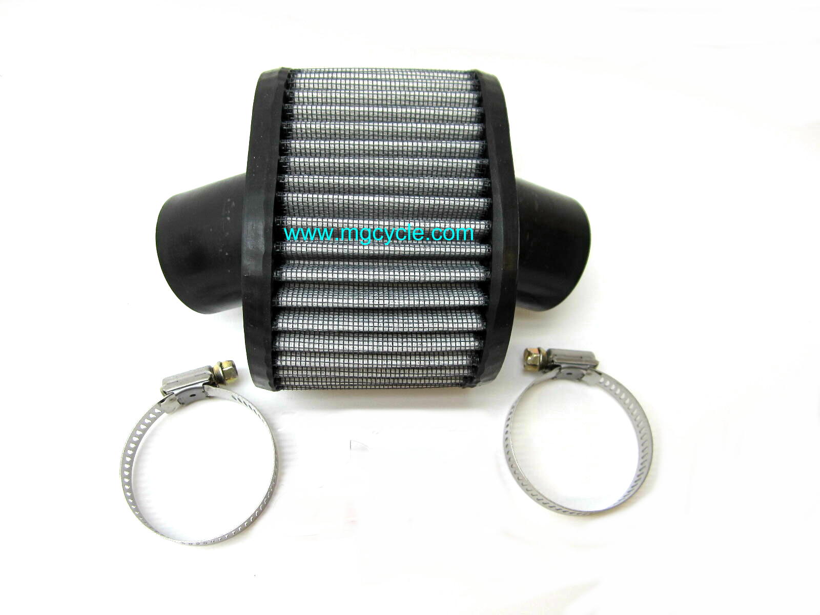

When I took over the bike a couple of months back it had one of the 5 legged air boxes, a double pod filter and a large plastic line poking out behind the number plate.
A smaller line teed off and stuck into the side of the K&N filter, these are the parts it had.
https://www.mgcycle.com/images/atrex/14155700.jpg  https://www.mgcycle.com/images/atrex/mg2640.jpg
The centre of the bike was an oily mess, that had to go.
I think the main reason the box was spewing oil, a PO had burnt a hole through the side of the 5 legged box and removed the one way valve patching the hole in the box with some sort of epoxy.
The oil breathed out of the engine through the breather box out the 5th leg into the filter then finally dripped out and all through the battery compartment, the long hose sticking out behind the number plate must have been to stop that.
The original box has a much simpler arrangement with the 5th leg venting directly into each carburetor throat well downstream of the paper filter. It doesn't have a one way valve either so I fitted one of the in-line ball valves from MG Cycle https://www.mgcycle.com/images/atrex/28150560.jpg Perhaps all it needed to make the PO's system work was this simple valve.
