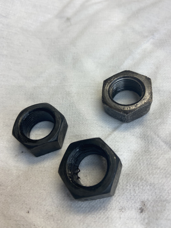

Re: NGC Question for the machinists
« Reply #18 on: January 27, 2022, 05:45:57 PM »
I made up a pair of M15 x 1.25 nuts using my lathe and small knee mill. I started with 1" (25.4mm) 1048 round stock. I could not find any tables for M15 nuts for tap drill size, the only referance was a general guide saying for metirc muts the tap drill is 1mm smaller than the tap, so in this case 14mm, I tried that but the tap was very tight so I bored out the hole to 14.15 and the tap went in nicely, slow going but a good cut with lots of tap cutting oil.
I used the method I found on Youtube to index the round rod on the mill table using a large hex nut. The nut faces were rough cast so I surfaced all faces with a fly cutter, then clamped the dowel to the table, cut the first face, then rotated the dowel 60 degrees aligned with a face of the big nut.
I blew the cut depth on the mill and ended up with a 21mm nut face rather than the 22mm nut face I was intending! I have a lot to learn.
After deburring I blackened the nuts and then coated them with ACF-50,
I am pretty happy with how this 1st attempt turned out.
