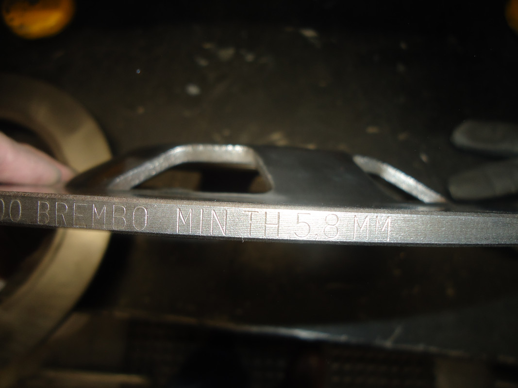

Re: TrueDisk
« Reply #12 on: February 07, 2022, 09:48:24 PM »
The rotors are stamped on the edge like this, these are the set that are on my 750S, I beleive they are the same discs on the 750 S3. LeMans uses a different style of disc, can you find the  minimum thickness anywhere on the disc?

« Reply #23 on: February 10, 2022, 03:46:39 AM »
I'm not certain but AFAIK the minimum thickness for those is 5.8mm. The number is perhaps cast in the rotor mounts.
Offline Frenchfrog
  • Posts: 930
Re: TrueDisk
« Reply #24 on: February 10, 2022, 04:32:28 AM »
 5.8mm is the minimum thickness.I've used ones that were thinner without any issues but....
