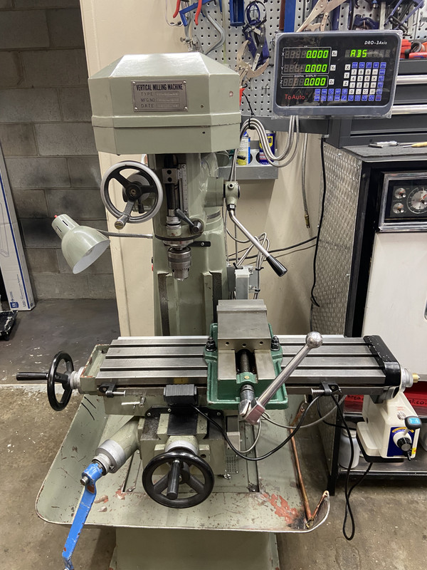

« Reply #19 on: February 22, 2022, 06:23:42 PM »
I bought a 3 axis DRO, glass scales kit off Ebay, from China, arrived in under 10 days, took a couple days to install, Its going to be great!
https://www.ebay.com/itm/384518307227?var=652609057569  under $300 USD delivered
I was surprised to see how accurate the hand wheels were conformed by the DRO, one full turn of my X or Y aixs is 4mm on the hand wheel and the DRO is almost bang on, reading 3.995
I did not underhang the Y axis reader, I may change that out if I find too many chips getting into the scale but I think it will be ok when I replace the way cover with a new rubber sheet
I had to cut out the chip tray to allow the power feed to run full left, not pretty but it works, copper pipe slit and slipped over the cut off tray :embarrassed:
One chip can do it. <shrug> Unless they are different than back in the day, it's a glass scale etched with lines every half thousandth. One scratch and the computer loses track of how many lines it has counted.
Amazing what you can get for $300..  :shocked: That kind of stuff used to be expensive.
Re: NGC another question for the machinists
« Reply #22 on: February 22, 2022, 07:46:32 PM »
Good point! It easy enough I suppose to flip the Y axis scale and reader over and make a hanging bracket for the reader. May as well fix it now.

« Reply #23 on: February 23, 2022, 05:42:17 AM »
:smiley:
Be careful with compressed air around those scales for the same reason. You really don't want to blow a chip past that seal. That said, I've had no problem in ..uhh.. 30 some years.
