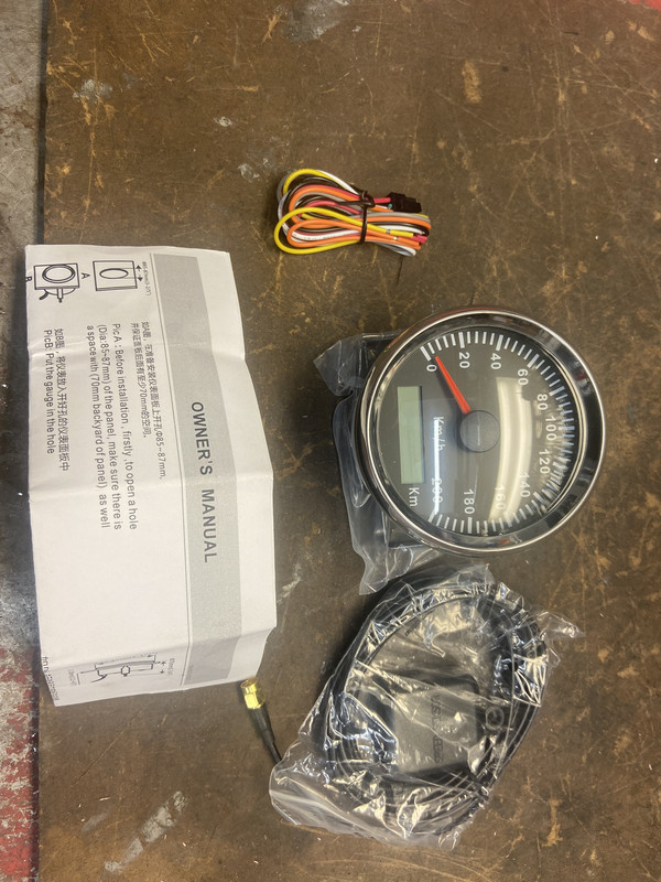

On eBay I found a GPS speedo (no tach) with a signal and high beam lights for cheap, but it is 3 5/8" diameter rather than the 4" that the bezel takes
Under $100 USD with shipping
https://www.ebay.com/itm/114991059514

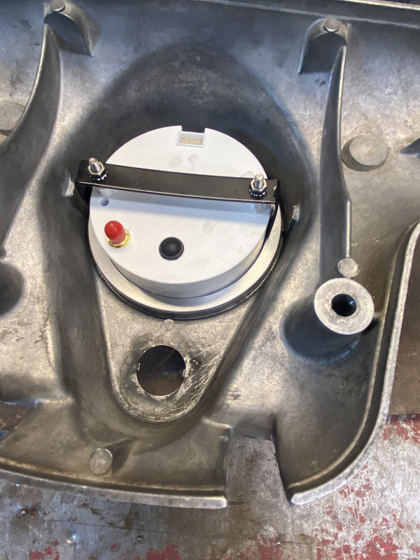

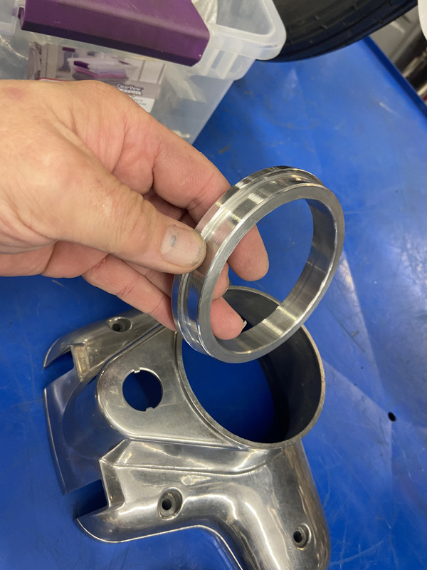

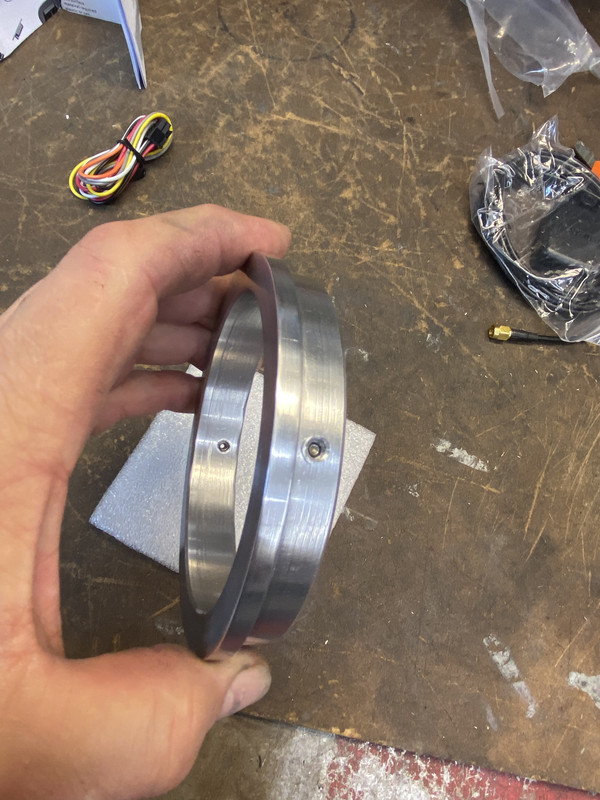

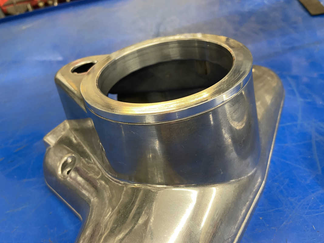

I made up a an adapter ring out of aluminum to drop into the Ambo bezel and take the smaller instrument, two 4 mm x .75 set screws through the sides of the ring snug it up to the dash piece

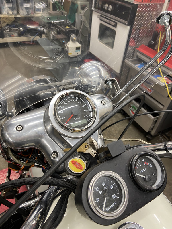

The wiring is very simple, power from key switch, ground, L and R signal, high beam and running light
the GPS antenna has about 8 feet of chord, I spooled it up and tucked it under the dash, secured with zip ties and then used 3M two sided mounting tape to secure the antenna to the vertical face of the master cylinder on my bike, anywhere with a line of sight to above will work
Once the key is on the GPS searches for a signal counting up from zero on the odometer until it reaches 300, at which time if no reception, it goes to error, and you have to switch off the ignition and start again. It took seconds to find the satellites once outside my shop and it works great!
The dash signal and high beam lights work fine but are a bit hard to see in sunlight. The background colour is orange / red.
I plan on fitting this speedo to a couple more of my vintage bikes, there is no fluctuation of the needle and by judging the traffic I was riding in for a couple hours of city and highway I think its accurate. After years of a crappy Veglia speedometer keeping me guessing as to the real speed I was travelling at this is a great replacement gauge for dirt cheap.
