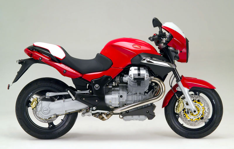

How can you tell if a Breva, is the Sport model, or the regular Breva. Here are photos of one that I’m interested in.
Seller says Breva Sport.
Is it?

In my very humble opinion, I'd say that is a Breva, not a 1200 Sport.  The 1200 Sport has a white dashboard background, not black like the Norge and Breva.  It also has a small fairing/cowl over the headlight, whereas I don't think that the Breva came with one standard.

The Breva in question does have the 1200 sport front forks which are much better than the stock forks. It also has traditional handlebars instead of the stock cast ones.

If memory serves the Breva 1100 are 2-valve, have titanium valve covers, cast handlebars and lower spec suspension. 1200 Sports are 4-valve (flat tappet issues?) have tube bars and came with matching fairing/seat cowl.

The bike your looking at is a modified Breva 1100.
There is a 1200 Breva that was released in some markets, but not  the US.  It was a standard Breva, but with the 1200 2v motor.
It appears that this Breva 1100, has 1200 sport upgraded forks, 1200 sport Mirrors, and sport handle bars.  It also has the valve covers from the 2v Griso, that were used on the 1200 Sport, in the US.   1200 Sports in the US market (despite what the pic above shows all came with pedal rotors, the Breva had standard round rotors).   The CARC on this bike has either been bead blasted to remove the paint, or it is a CARC taken off a 1200 Sport.   I don't know if the gearing is the same between the two models.
Lastly, it has standard Breva 1100 body work.

Breva Sport was: (at least CONUS)
1. A 1200 4V cc motor
2. White faced gauges (Breva had black)
3. Special Cowl on handlebars and seat with white flash
4. Says 1200 Sport
5. Better Forks and suspension
6. twin plate clutch (believe Breva had single plate)
7. Standard handlebars (Breva 100 had a kind of riser for handle bar on each side, 1200 Sport had a traditional bar)
That's a plain Breva 1100, but the valve covers look like a Griso 1100 or 1200 Sport, and maybe ther forks from a 1200 Sport too. However, if it has Guzzitech parts it is automatically a sport!  :violent1: :drool: :violent1: :drool:  I kid I kid.  It may have some upgrades to make it more sporty, but it is a standard Breval and in the end, this is a great platform all around. Decent ergos, handling, power, etc. BNS's rule!

1100 Breva's sell for bargain prices (that can be good or bad, depending upon whether you're buying or selling). 1200 Sports retain much better value.
1200 Sport had a horrible handlebar. You had to be a gorilla to ride one, which is why many have been altered with Aprilia Mana bars. In fact, they received such poor response on the showroom floor as a result...that's one of the reasons that it was a one-year-only bike. 1100 Breva's had nice, comfortable cast risers.
If an 1100 Breva has hard bags, they're usually the black, triangular Aprilia units. 1200 Sports are routinely fitted with color-matched (red of black) Norge bags.
Don't consider buying a 1200 Sport if it doesn't have its bikini fairing and rear seat cowl.
