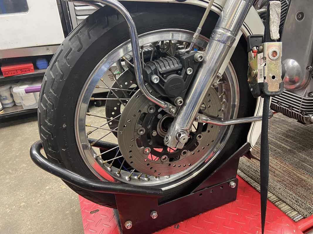

One works as good as the other in original form. Disc is better if doubled up with the proper sized master. Hard to beat double disc for braking performance.   DonG

4LS.  It's just way cooler and looks totally right on an Eldo.  Properly set up and maintained, it is just as effective as the single disk.  (I owned a 4LS Eldo.  Also, aggressively riding an 850T with the same single disk on a challenging road, experienced serious brake fade.  And the T was a much lighter bike.)
Now if you're going to put the second disk/caliper on the the single disk front end I would change my opinion.  (That's what I had to do to my T.)

I love the look of the Guzzi double sided 2LS used in the V7 Sport and Eldorado. I had a V7 Sport with the double sided 2LS and it worked well. Years ago I converted my 72 Eldorado to twin discs with a proper sized master cylinder from MG Cycle. I used modern floater discs and new Brembo calipers. The braking performance is very good. If you are looking for two finger pull brakes that keep working time after time then dual discs is the best choice IMHO.
