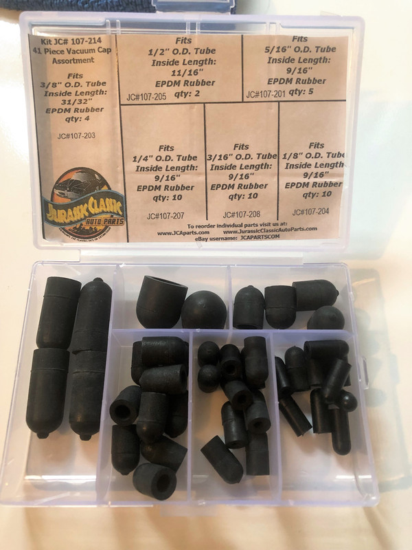

This sounds like the infamous V7-850 hiccup.  It has been a well documented and somewhat common ailment.  The good thing is 50 cents and five minutes of your time will fix it.
The problem resides with the evap control system on stock bikes.  Rather than remove the whole evap system as many prefer, I just removed the lower hose from the Evap control valve and capped it with a rubber cap.  Works like a charm.
It took me longer to figure out the right push/pull combo to get the left side cover off (refer to your owners manual) than doing the fix.  Stop at your nearest hardware store to find a proper sized rubber cap.  Don't worry about plugging the hose that is removed, its not necessary.

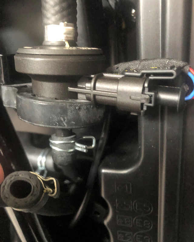

So I bought a evap kit off the internet with a rubber cap. Successfully removed said hose to find the cap doesn’t fit! (Typical) now I’m trying to put the hose back on and I CANNOT get this damn clip back in. I’ve never seen one of these, it’s not a usual spring loaded or jubilee clip.
Any advice?!

« Reply #16 on: August 12, 2024, 07:04:49 AM »
Any advice?!
Go down to your hardware store and buy a cap or a stopper.  Job done.

Thanks but I mean any advice for getting that clip back on until I can get some caps! Like you have on the hose you have detached. I note you have put a different clip on?
  • Posts: 4777
Re: V7 850 Stone - power dip ?
« Reply #18 on: August 12, 2024, 08:33:51 AM »
Any hose clamp will do. For now you could seal it off with Duck Tape temporarily.  Doesn't need to be fancy.

« Reply #19 on: August 12, 2024, 12:38:01 PM »
What Dave says. Those crimped clamps are a one time use.
